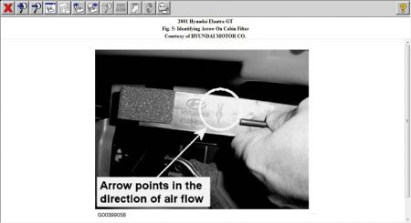

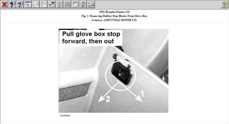

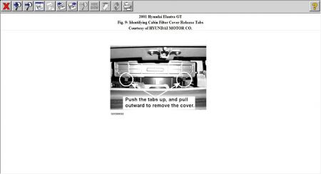

In my car, I am not able to find out the place where tthe cabin air filter is installed. Can anyone point out for me pls ? Thanks.
May 26, 2009 at 3:04 PM
  • 75,988 POSTS
Its behind the glove box
https://images.2carpros.com/forum/automotive_pictures/12900_gb1_1.jpg
https://images.2carpros.com/forum/automotive_pictures/12900_gb2_1.jpg
https://images.2carpros.com/forum/automotive_pictures/12900_gb3_1.jpg
