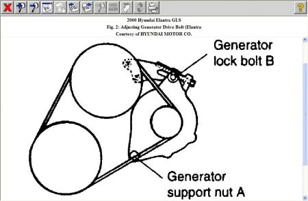

2000 Hyundai Elantra 4 cyl Front Wheel Drive Automatic
hi sqeaking noise that got worse,heater not blowing hard,espeacially when squeaking,shut car off wont start back up until jumped.2 belts top & bottom by alternator dont know which is which please help! will donate if help (216) 647-1873

Hi Sofia, The digram shows the alternator drivebelt. Since there is squeaking noise, it could be a bad crankshaft pulley that is causing the beltings to slip and not providing sufficient charging. Check the belting condition and tensions as well.
