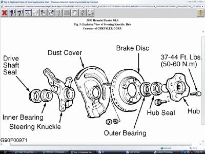

How do you remove the front rotors? I purchased a puller to assist. I attempted this job but was not successsful and had a manual.

You remove the axle nut, bolt the puller to the flange with the lug nuts, and start pounding away! Unless you have done these before, I would let a qualified tech do it...if it doesnt go back together right, you will be changing the hub bearings too!
