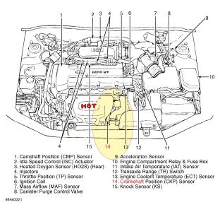

where is the crank position sensor at? and what do i have to do to replace it?

hope that clear thinks for you you can use an ohm meter to check it and if you are using a scanner u check for pending codes check for RPM reading while engine cranking
https://images.2carpros.com/forum/automotive_pictures/99387_hyunda_1.jpg
