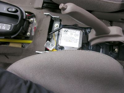

1998 hyundai elantra bought from original owner with 34,000 miles. drove it a few days and the airbag light came on. Trieid to scan for an airbag code and could not communicate. Took it to the hyundai dealer and they tried 3 different computers and had no communication. They recommended I buy an airbag module. I did(a used one) and it changed nothing. Now the dealer says it will cost around 600 dollars to track this down. I don't have this kind of money- any help will be appreciated.

With no communication it is impossible to pinpoint fault. Dealer would have to check every module , sensor ,wiring ,clockspring etc. and that would cost.
The moduel you replaced was it in steering wheel? Turn key on does SRI light flash 6 times?

airbag light flashes 7 times. The module is under the center console! Picture included
https://images.2carpros.com/forum/automotive_pictures/71362_DSCN1865_1.jpg

Well according to Hyundai if light flashes approx. 6 times system is good. Try disconnecting battery wait one minute reconnect. See if light goes out.

I did disconnect the battery when I installed the new module- I did it again today- Left the negative terminal off approx 2 minutes. Reconnected it and turned on the key- It flashed 6 times and stayed on-
What do I do now????

Well your at what dealer suggested every component will need to be checked. Wiring diagram.component locator, digital volt ohm meter and test light will be needed.
