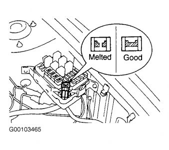

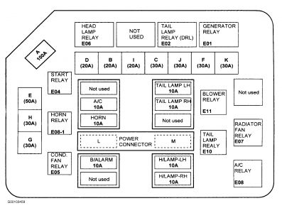

have a 1997 elantra 4cyl, have no back lights & I can't find the right relay. where th heck is it?
Nov 9, 2008 at 1:49 AM
DAVE H
  • 13,384 POSTS
engine compartment relay/fuse box
