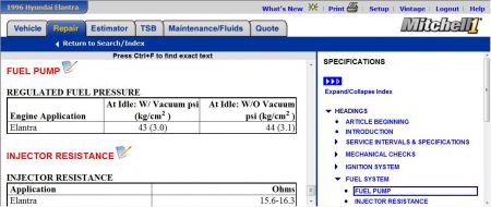

Hi mistri, Welcome to 2carpros and TY for the donation
Lets start by checking the actual fuel pressure and get back with the readings and also check if the injectors are pulsing

Your fuel pressure is way too high check the fuel pressure regulator and fuel return line -See below

One important thing to mention, I took my fuel
presure at the top of the fuel filter, I don't have T setup.
I check the fuel return line at the fuel pump,
When I crank it returns the fuel.
Ashk
Tuesday, April 27th, 2010 AT 2:10 PM
  • 75,992 POSTS
What is it doing now? Your fuel pressure is too high
