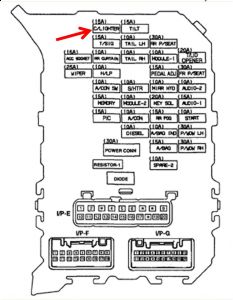

How do I replace a blown cigarette lighter fuse? As per manual, I opened panal on left hand side od Dash board. No fuses just a black box with 4 tiny screws.

Hello -
From what I show it is located on the passenger side.
Below is the pic of the fuse box so that should help with the size and I put a red arrow at the fuse in question.
