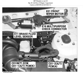

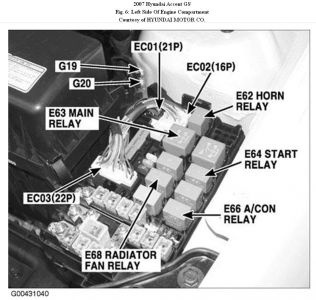

PCM = Power Control Module, the engine computer. Symptoms indicates the PCM is not grounding the circuit at ignition ON and that couls be due to a fault with the PCM or its power supply. Ensure the security system is not activated ( if equipped). The immobilizer would prevent the engine from being started. Check the main relay, try swapping it out.

I have installed a new purge valve on the vapor canister, its got a new fuel pump assembly installed, I have checked the fuel pump relay, and the main relay, as far as I can tell they both are ok.
Is there anything that im overlooking that would cause the fuel pump not to prime to create the required pressure needed so the car would fire?
Is there any type of switch on these Accents that would interrupt the fuel pump from priming? As I stated before the pump will pump gas but only while your cranking the engine over, once you leave the key go and it returns to the ON position the pump shuts off! So it never really gets the pressure up to whats required so the engine will fire up.
I didn't know if there was a fuel cut off switch on this car I have looked around for one but dont see anything of the sort...
WhenI put a test light on the plug that goes to the fuel pump it only lights up HOT when you turn the key onto the cranking position, nothing lights up when you turn the key to the ON position, does or could anything around the vapor canister interrupt power to the pump? Where does the power come from when the key is on the ON position to prime the pump since there are wires that run back to the canister from the pump, im not sure but I dont believe I could have put the plug on backwards on the purge valve, I thought it would only go on one way but I guess I could get under there and check anyways.... is there another valve,relay,or fuse somewhere I should be looking for? This thing has me about nuts, Haven't been able to start this engine now for a couple weeks and its driving me crazy on where to look next, I just cant believe the PCM would just up and go bad when only a few weeks ago I had it reprogramed at the dealer costing me just over $100.00 and it ran good for weeks ater that until just recently, when we had the problem with it not starting after getting gas, hope somebody has another idea where I can turn or what I can try next! I did have the battery out for 2-3 days to charge it then re-installed that wouldn't have messed anything up?

The fuel pump relay is energised by the Blue/Orange wire being grounded by the PCM and would go off once the ignition is released as no cranking signals are received by the PCM.
The priming of the fuel pump would only occur when the ignition is turned from OFF to ON. You need to turn the ignition OFF and back ON for the pump to prime. If it is not occurring, the PCM could be faulty.
