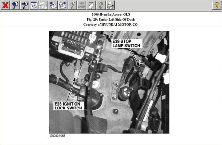

how do i change stop switch in my accent
Feb 27, 2009 at 7:05 AM
KHLOW2008
  • 41,814 POSTS
Hi shamrox06, You need to get under the dash. Unplug the switch wire connector. Unloosen the lock nut. Turn out the switch. Install New switch. CAUTION. Ensure adjustment is correct with sufficient pedal free play, ( clearance between switch must be sufficient to prevent brake from self applying).
