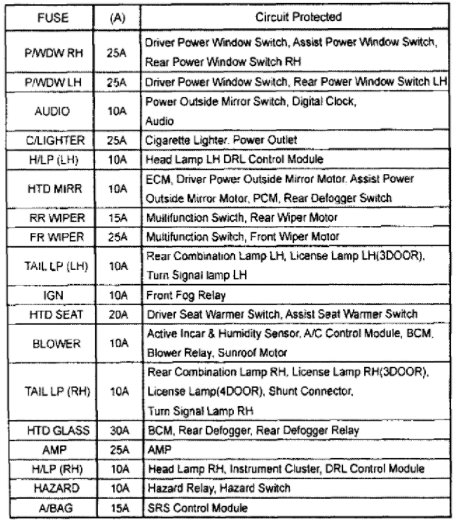

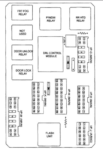

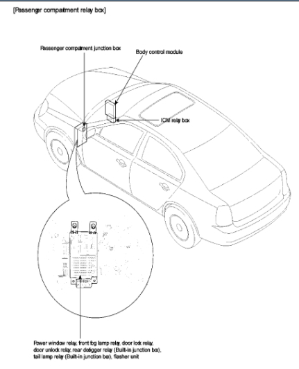

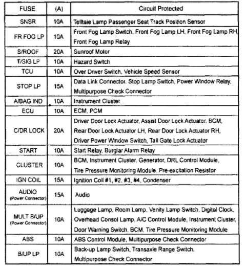

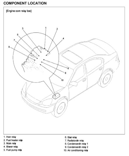

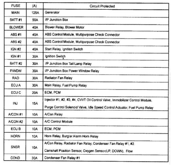

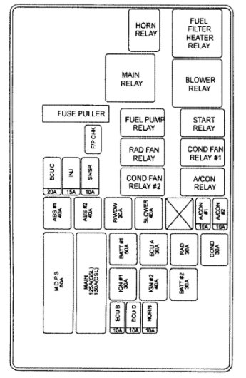

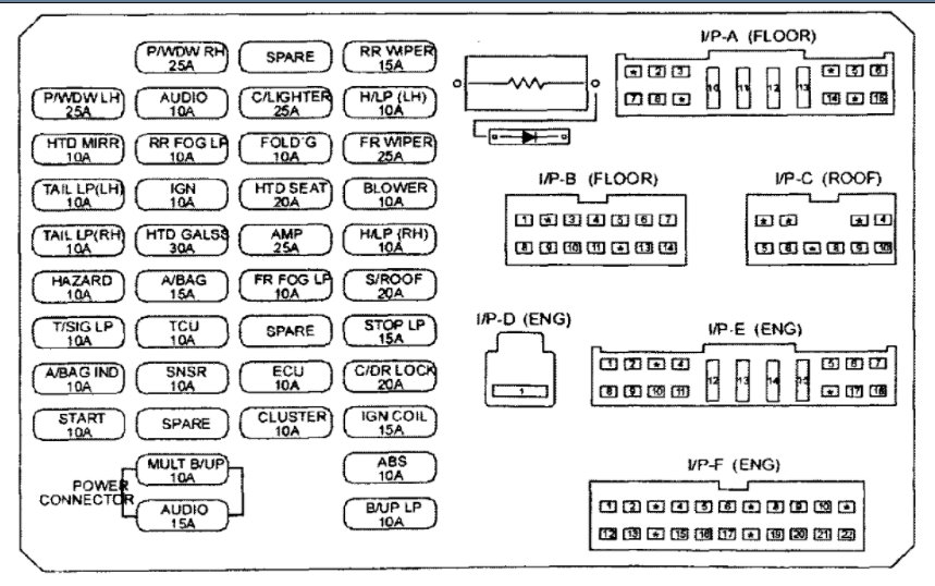

Where the fuse panel is how do I check the fuses? I have a rear brake light out.
Jul 6, 2008 at 8:26 AM
DANNY L
Experienced Mechanic
5,648 POSTS
Hello, I'm Danny.
Here is the information you requested. Here are few tutorials for you to view on how to check and replace fuses:
I've attached pictures below showing the fuse and relay locations on your car. Hope this helps and thanks for using 2CarPros.
