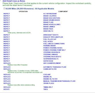

I have talked to you earlier about procedure of replacing timing belt. One more question. At 60,000 miles, in addition to replacing timing belt, water pump, do I need to replace IDLER PULLEY, BELT TENSIONER, ALL OTHER BELTS, RADIATOR HOSES, TRANSMISSION FLUID? Thank you for your help.

Severe Maintenance Labor Hours APPLICATIONLABOR TIME Automatic Trans 6.1 Standard Trans 5.3 Severe Maintenance Details Add Detail Lines as Notes Please Note: Check each box that applies to the current vehicle configuration. Inspect the worksheet carefully, and edit the detail items if necessary. 60,000 Miles (96,000 Kilometers) : All Applicable Models OPERATIONCOMPONENT INSPECT A/C REFRIGERANT INSPECT BRAKE CALIPERS INSPECT BRAKE DISCS/ROTORS INSPECT BRAKE DRUMS/SHOES INSPECT BRAKE FLUID INSPECT BRAKE HOSES & LINES INSPECT BRAKE LININGS INSPECT BRAKE PADS INSPECT DRIVE BELTS Water pump, Alternator and A/CON. INSPECT DRIVESHAFT BOOTS INSPECT EXHAUST PIPE & MUFFLER INSPECT FUEL FILLER CAP INSPECT FUEL HOSES INSPECT FUEL LINES & CONNECTIONS INSPECT PARKING BRAKE INSPECT POWER STEERING HOSES INSPECT POWER STEERING PUMP BELT INSPECT STEERING GEAR/RACK INSPECT STEERING LINKAGE INSPECT STEERING RACK BOOTS INSPECT SUSPENSION BOLTS INSPECT VAPOR HOSE REPLACE AIR CLEANER/ELEMENT Replace more often if required. REPLACE AUTOMATIC TRANSAXLE FLUID REPLACE CABIN AIR FILTER Replace every 12 months or every 12000 miles, whichever occurs first. For evaporator and blower unit. REPLACE COOLANT REPLACE ENGINE OIL REPLACE ENGINE OIL FILTER REPLACE MANUAL TRANSMISSION/TRANSAXLE FLUID REPLACE SPARK PLUGS Replace more often when extensive idling. REPLACE TIMING BELT ROTATE TIRES

[quote:6d5a2a1186="hiltonn"]2005 Hyundai Accent 4 cyl Two Wheel Drive Automatic 59,550 miles
I have talked to you earlier about procedure of replacing timing belt. One more question. At 60,000 miles, in addition to replacing timing belt, water pump, do I need to replace IDLER PULLEY, BELT TENSIONER, ALL OTHER BELTS, RADIATOR HOSES, TRANSMISSION FLUID? Thank you for your help.[/quote:6d5a2a1186]
Your answer wasn't exactly what I needed to know. I'll ask the question this way.. Would You replace the above parts at 60,000 miles if it were your car? Many thanks.
Apr 15, 2010 at 10:52 PM
BMRFIXIT
  • 19,053 POSTS
Other belts: yes
Hoses: just check
IDLER PULLEY, BELT TENSIONER: only if needed not recommended
ALL OTHER BELTS: we always replace them
RADIATOR HOSES: only if needed
TRANSMISSION FLUID: yes
