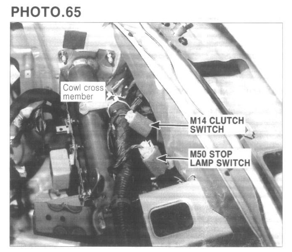

All 3 lights are not working when we press the brake pedal. Bulbs ok ( we swapped a new one to be sure, fuse ok, also switched in a new fuse). I got it fixed but they tell me I need brakes
May 4, 2009 at 3:15 PM
SQM
  • 6,383 POSTS
This sounds an issue with the brake light switch.
The brake light switch is located under the brake pedal. When you depress the brake pedal, the switch gets pushed and the brake lights turns on.

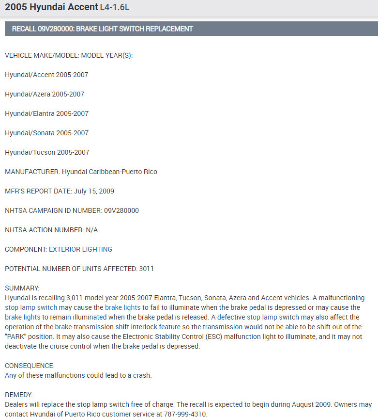

Hyundai also had a recall with regard to these brake light switches as well.
So, call the dealer and provide them with the VIN. They can tell you if that recall was performed.
