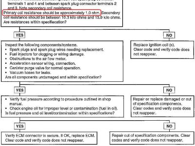

Can you get the engine scanned again, and give the codes? From the look of it, (just a guess, either the wires or your coil pack), but don't change anything until we get the proper diagnostic..

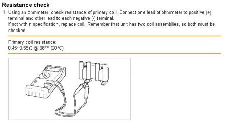

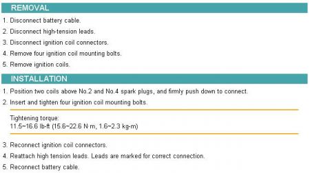

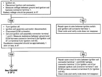

1. Pull spark plug #4. Check the gap. Should be about .04". You did get NGK BKR6ES-11, right? 2. Next test your coil. You have 2 coils in 1, and each coil has 2 plugs connected to it. Check the plug wires (one at a time), make sure that there is no burn marks from spark "jumps", frayed or cut wires. Here is how to check the coils.
https://images.2carpros.com/forum/automotive_pictures/55316_04accentcoil1_1.jpg
https://images.2carpros.com/forum/automotive_pictures/55316_04accentcoil2_1.jpg
https://www.2carpros.com/forum
/automotive_pictures/55316_04accentcoil3_1.jpg
https://images.2carpros.com/forum/automotive_pictures/55316_04accentcoil4_1.jpg

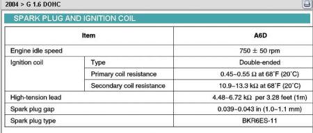

Are you sure on the apsrk plugs?? If you go to the NGK site and type in '04 Accent...BKR6ES-11 does not come up...its a BKR5ES11 is the OEM part for it. I think the ones we put in were GP platinum BKR5EGP. I will check the coils and see what I can find there and maybe have to change the plugs back to the OEM.

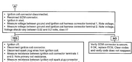

https://images.2carpros.com/forum/automotive_pictures/55316_04accentcoil3_2.jpg

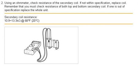

Just realize you are missing the secondary coil test. Back to your question about the spark plug. I got my info from Hyundai's TSB. BKR5ES-11 is equivalent to BKR6ES-11, except it is a hotter plug. It your driving is more highway than city or stop-and-go, you have the better plug. But if you do more city and stop-and-go, you may want to consider going with the 6, colder plug. I am not a fan of platinum plugs unless it is specifically required the OEM specs. I am not saying that they aren't good, I just have always follow what the OEM specs. Do this, while you are checking the coils, pull #1 and #4 plugs, and compare them. (It would be useful if you can snap a picture and post them.) Check if they are burning off differently. And then swap them. Put #4 plug into #1 cylinder and vice versa. I would be surprise if your next check engine light will show #1 misfire. If it is, then you know that particular plug is defective.

Other than making sure your idle is between 650 - 850 rpms, no other adjustments are necessary. Check these meters out, decent price great range. I am just curious to see the numbers out of the coils.

Aight got it done. I did this morning, kinda dark and a lil chilly, so I hope I got it right...
Primary - .9 & 1.1
Secondary - 11.98 & 11.79

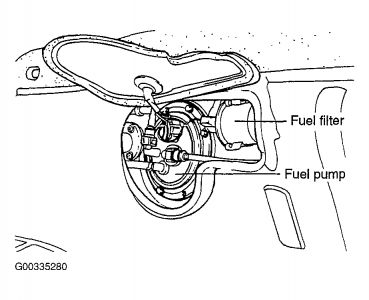

I am gonna give the primary another shot this evening when I get in from work. Also, if you could help me locate the fuel filter on the car as well. This is my wifes car and can only go on what she tells me. When she gets gas it bogs down a little.

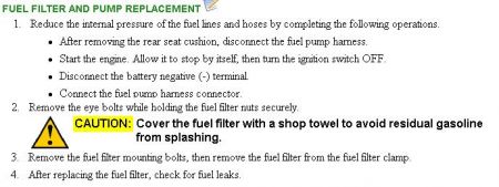

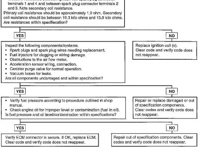

You may want to check the primary again. Those numbers are way off. Fuel system
https://images.2carpros.com/forum/automotive_pictures/55316_04accentfuel_1.jpg
https://images.2carpros.com/forum/automotive_pictures/55316_04accentfuel_2.jpg

I get the same set of numbers for the primary. ANy ideas??
Feb 19, 2009 at 10:01 AM
ZACKMAN
  • 4,202 POSTS
I believe your coils are fine. Look at my first post. The diagram does say that the coils should be around 1 Ohm. As each coil is double-ended and serves two cylinders, I would imagine the table is meant for each cylinder.
https://images.2carpros.com/forum/automotive_pictures/55316_04accentp0300_3_2.jpg

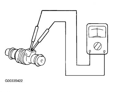

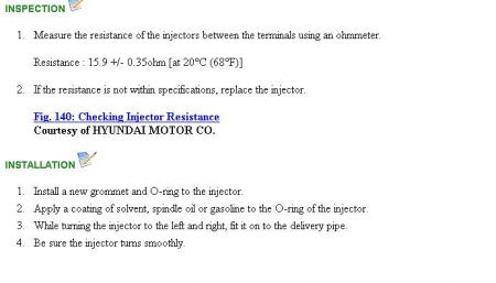

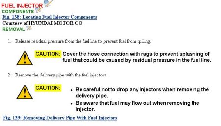

I would then continue with the troubleshooting and focus on fuel delivery. Check your fuel filter and possibly cylinder 4 injector clogging/leaking.
Feb 19, 2009 at 2:42 PM
JOSHUA LYNCH
  • 10 POSTS

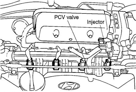

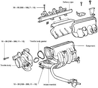

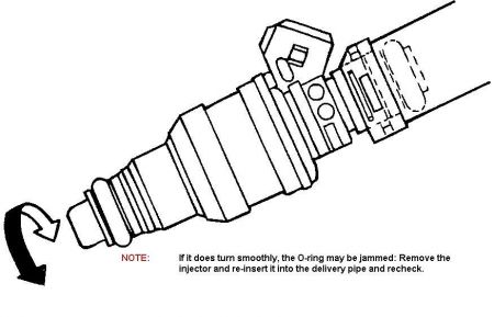

Alrighty. We're getting the fuel filter changes tomorrow. I will get them to look at the injectors. You got any diagrams on removal of those??
Feb 19, 2009 at 9:31 PM
ZACKMAN
  • 4,202 POSTS
https://images.2carpros.com/forum/automotive_pictures/55316_04accentinjector_1.jpg
https://images.2carpros.com/forum/automotive_pictures/55316_04accentfig138_1.jpg
https://images.2carpros.com/forum/automotive_pictures/55316_04accentfig139_1.jpg
https://images.2carpros.com/forum/automotive_pictures/55316_04accentinjector2_1.jpg
https://images.2carpros.com/forum/automotive_pictures/55316_04accentfig140_1.jpg
https://images.2carpros.com/forum/automotive_pictures/55316_04accentfig141_1.jpg
