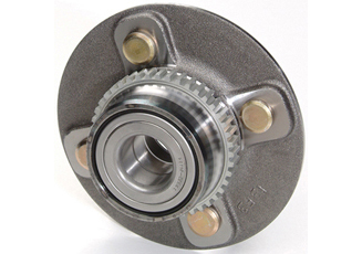

My neighbor thinks it need a wheel bearing. Just had the rear brakes done
Can you give me a ball park price for this repair?

I assume it's two wheel drive? if it's four wheel, post the engine size please. If 2 wheel drive, part is under 100.00 and labour is not more than 1 hour...200.00 MAX! Easy enough to do, just remove the large nut remove drum or rotor, pull bearing and replace with a new one. Use a new nut!
https://images.2carpros.com/forum/automotive_pictures/62217_NATHF_512192_BAC_1.jpg
Get the torque spec from parts store!
