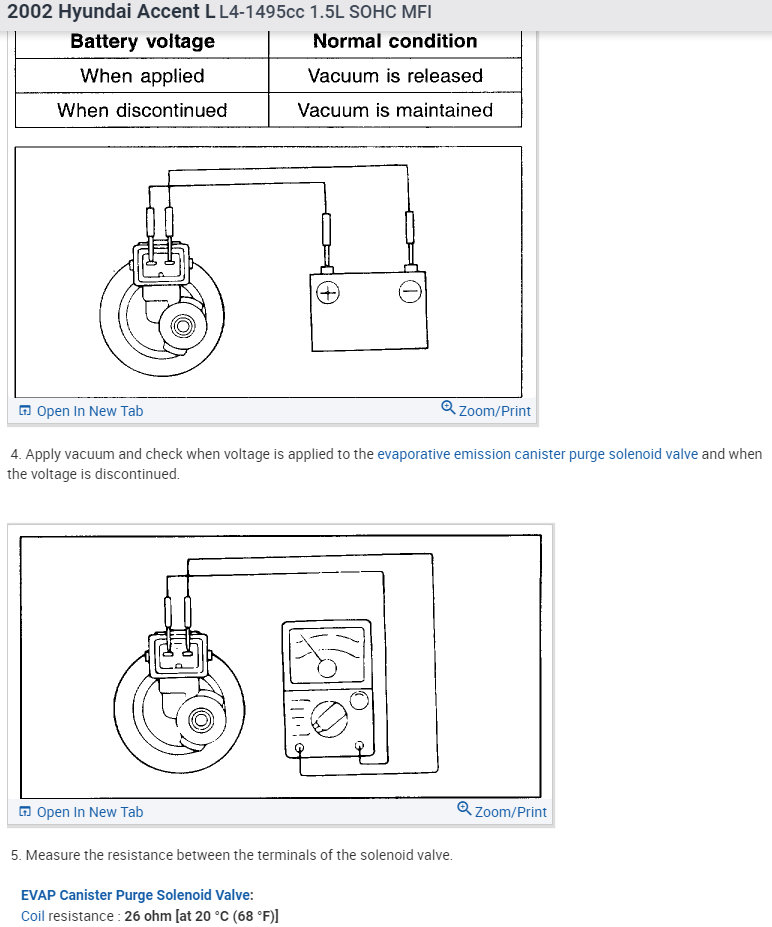

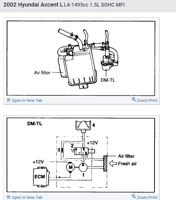

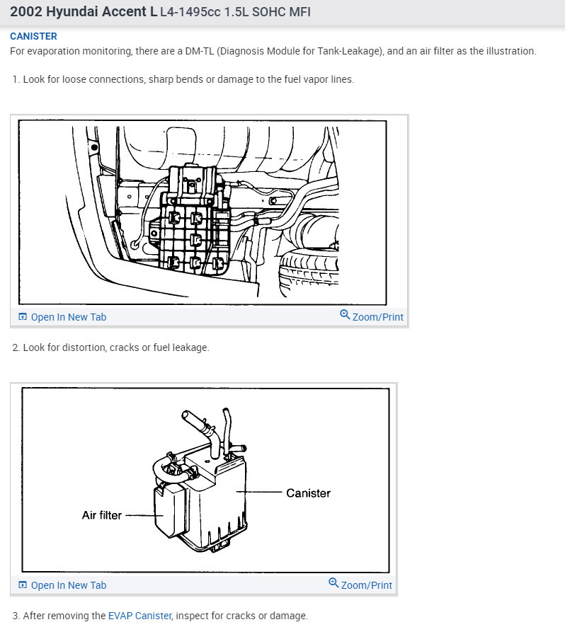

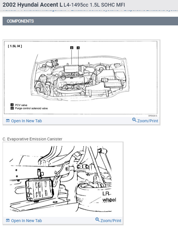

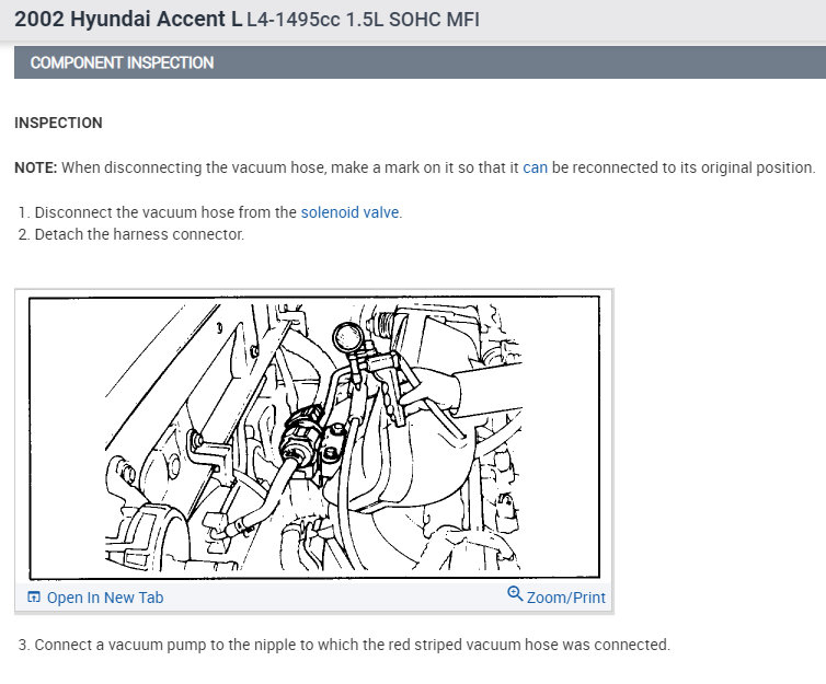

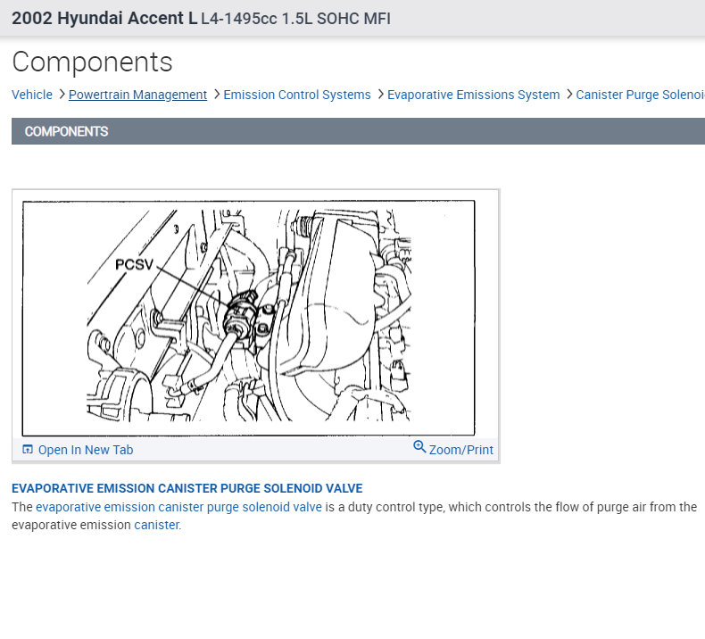

This issue typically happens when the fuel tank does not get vented properly as the fuel gets added. This creates a bottle neck affect and takes a very long time to fill up.
This issue is due to a clogged EVAP charcoal canister or a faulty vent valve.
Either of these will keep the fuel tank from venting.
Many times, these types of issues will trigger the check engine light. Is the check engine light illuminated? If so, scanning retrieving the code(s) can help with the diagnostics.
https://www.2carpros.com/articles/evap-system-code-repair
