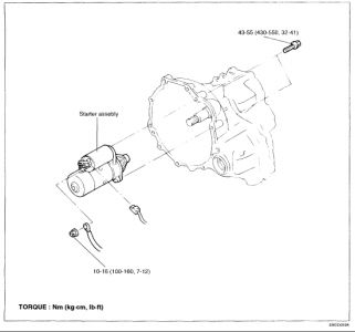

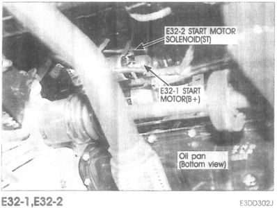

Need to replace starter and need to know location and procedure
Sunday, January 10th, 2010 AT 7:28 PM
  • 75,992 POSTS
STARTER MOTOR:
https://www.2carpros.com/forum/automotive_pictures/12900_startermotor_1.jpg
https://www.2carpros.com/forum/automotive_pictures/12900_startermotor2_1.jpg
1.Disconnect the battery ground cable.
2.Remove the speedometer cable and the shift cable.
3.Disconnect the starter motor connector and terminal.
4.Remove the starter motor assembly.
5.Installation is the reverse order of removal.
