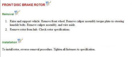

2002 Hyundai Accent 4 cyl Front Wheel Drive Manual
having problems removing front rotors

https://images.2carpros.com/forum/automotive_pictures/261618_Noname_442.jpg
if rotor seems stuck after removing proper components, bang on rotor with rubber headed mallet to loosen it up. brake heat makes them stick and seem as though something else is holding it.
