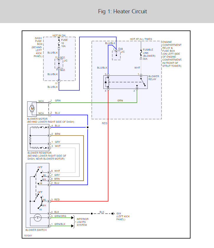

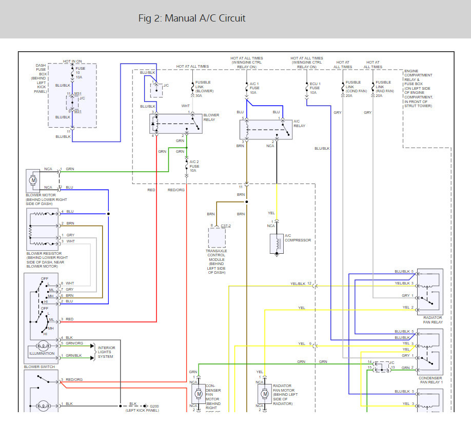

When I push the a/c button, it doesn't light up and the air doesn't turn on. Please help, it's hot out here!
Jul 17, 2008 at 2:05 AM
KHLOW2008
  • 41,814 POSTS
Hi jkbars,

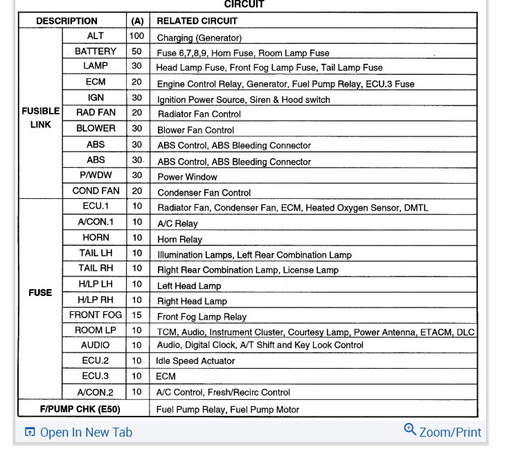

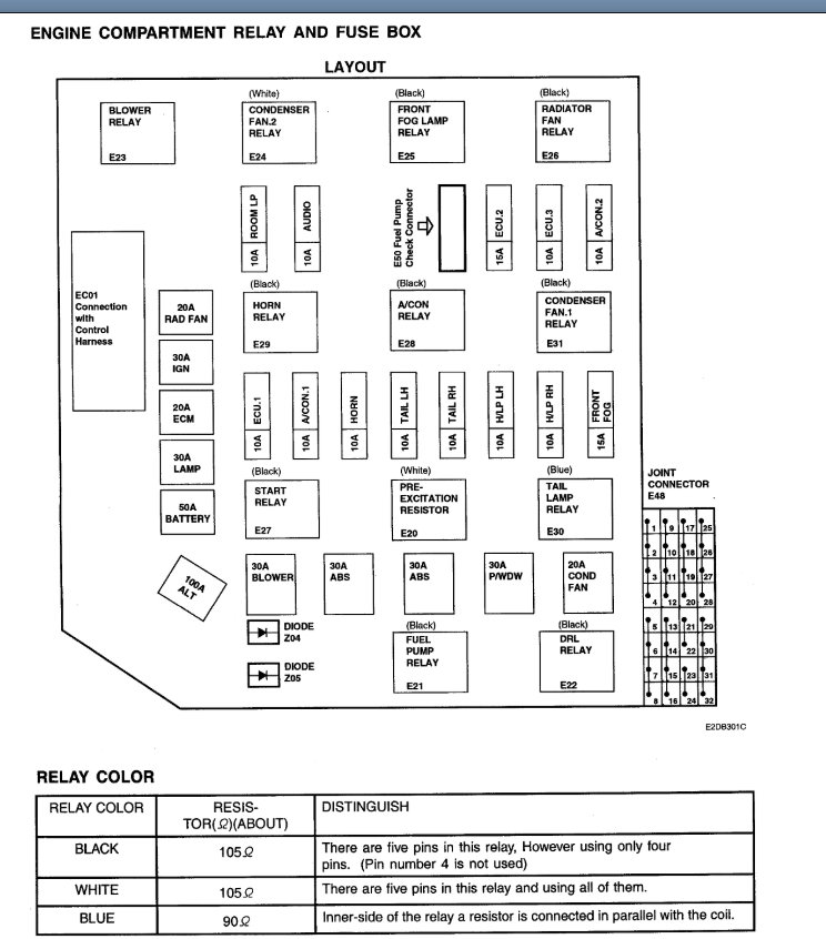

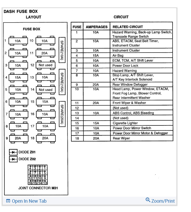

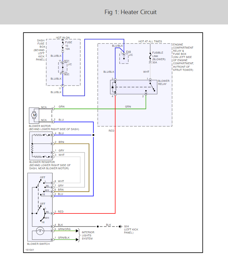

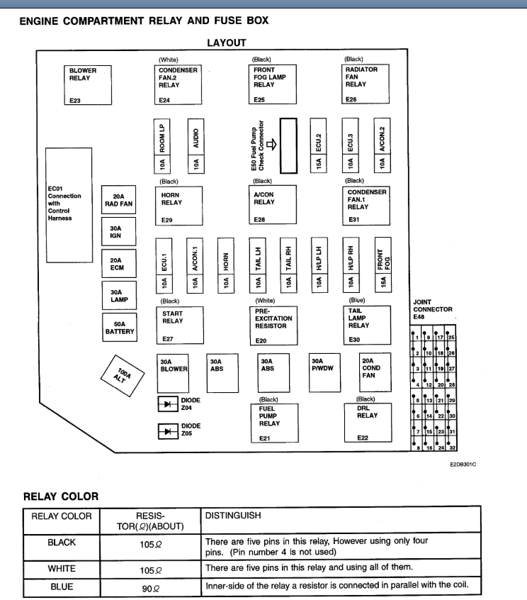

If the blower and AC compressor switch is not working, you need to check for a blown fuse #10 here is a guide to help and the fuse location along with the AC and blower motor wiring diagrams.

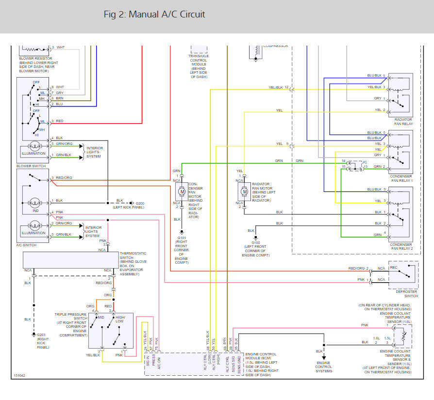

I have hyundai accent had a blow out when it happened it tore some of the wires out ive got everything working except the ac. there is one wire left it is red with a yellow stripe. Could that be the one to the ac. I didnt want to try it then something go wrong incase its not it.
Feb 19, 2021 at 4:21 AM (Merged)
DOCFIXIT
  • 18,828 POSTS
wire to compressor shows Yellow is there any wire left on Comp?
MARK_WHITE566
They put all the wires back together including the yellow wires but it still wont work
DOCFIXIT
  • 18,828 POSTS
is there voltage on wire?
