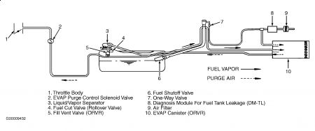

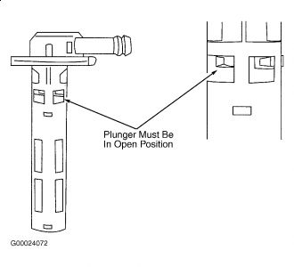

When filling care with gas, the hose continues to click, stopping the fillup procedure. This started about 2 weeks ago. The gas entrance area looks fine. Can u suggest cause and resolution please, thx.
Aug 11, 2009 at 9:31 AM
DOCFIXIT
  • 18,828 POSTS
Hi here is what's going on. Either liquid-vapor seperator, fill vent valve or fuel cut of valve. see diagrams
https://images.2carpros.com/forum/automotive_pictures/198357_Graphic_49.jpg
https://images.2carpros.com/forum/automotive_pictures/198357_Grafic_3_7.jpg
Fill vent valve most likely if you generaly bump more fuel in after nozzle cutoff. Check with Hyundai they have had issues with this. Hope this helps Thanks for donate
