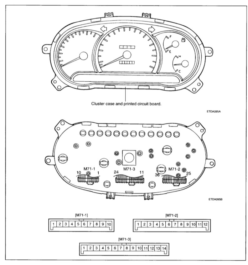

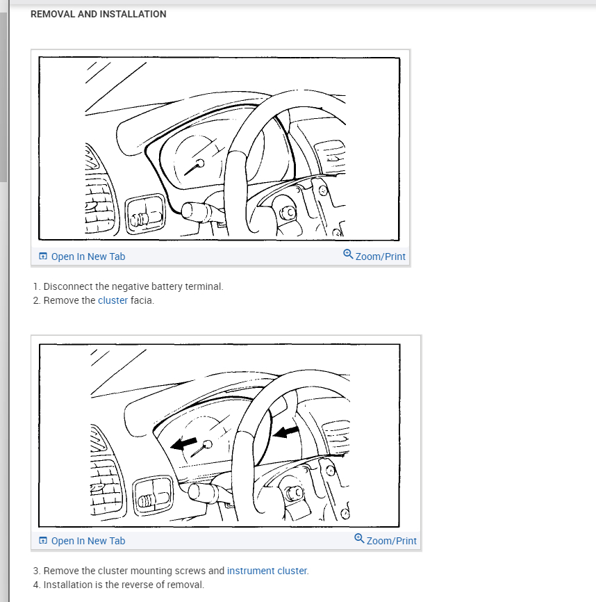

The left side dash light is out so it is hard to read the speedometer at night, how do I replace it?
Jul 24, 2010 at 7:02 PM
This cluster is very easy to remove.
There should be a screw on each side of it and you simply remove these and pull it out.
I am attaching the info below from the manual that will show how to replace this.
While this is a different vehicle, there is good info in it when trying to remove a cluster that others may benefit from:
