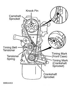

Timing belt diagram
JOHN KINCH
  • 2001 HYUNDAI ACCENT
I need picture of timing belt marks
Tuesday, August 25th, 2009 AT 6:52 PM
18 Replies
BLUELIGHTNIN6
  • 16,542 POSTS
This guide shows you the camshaft timing marks toward the bottom of the page.
https://www.2carpros.com/diagrams/hyundai/accent/2001
-1
Tuesday, August 25th, 2009 AT 11:04 PM

I would like to know how to line up the timing marks on the engine because my belt broke and now the timing needs to be lined up
Thursday, July 18th, 2019 AT 1:28 PM (Merged)
BLUELIGHTNIN6
  • 16,542 POSTS
https://www.2carpros.com/forum/automotive_pictures/261618_Graphic_747.jpg
+5
