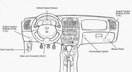

I was just wondering where the speed control sensor is located?
Mar 21, 2009 at 10:34 AM
MERLIN2021
  • 17,250 POSTS
VSS (vehicle speed sensor) inside the instrument cluster with the speedometer.

So the speed control sensor is in the engine behind the speedometer?
Mar 21, 2009 at 6:46 PM
MERLIN2021
  • 17,250 POSTS
Not in the engine, it is behind the instrument cluster (dash board).

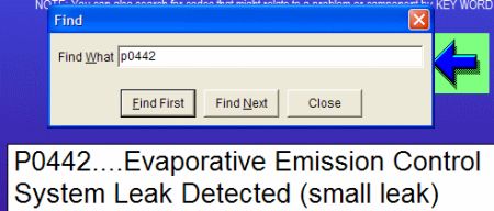

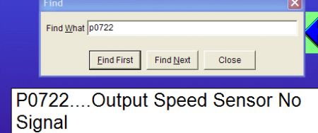

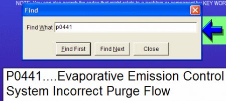

Three codes came up and I cannot remember what what is what, but they are codes P0441,P0442 and P0722.
Mar 22, 2009 at 2:46 PM
MERLIN2021
  • 17,250 POSTS
https://images.2carpros.com/forum/automotive_pictures/62217_p0441_1.jpg
https://images.2carpros.com/forum/automotive_pictures/62217_p0442_1.jpg
https://images.2carpros.com/forum/automotive_pictures/62217_p0722_1.jpg
Try checking the gas cap for the 442, and the only speed sensor I can find on your car is the one I posted.
