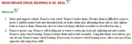

I have the new brake shoes, but I am unable to remove the brake drum. What size is the spindle nut that holds it on and is there a trick to getting it off.

https://images.2carpros.com/forum/automotive_pictures/261618_Noname_1465.jpg
