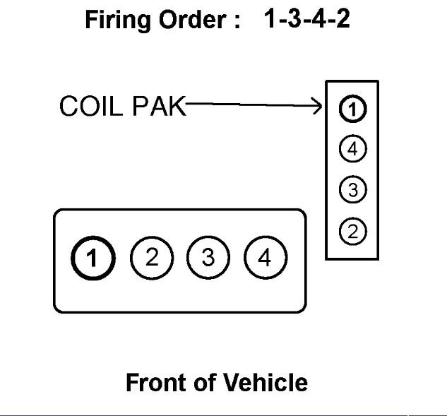

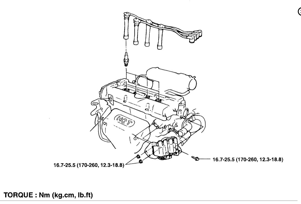

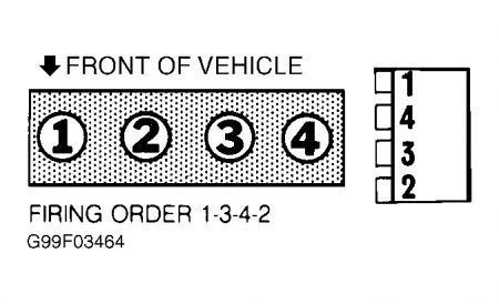

BUCKEYETAXI

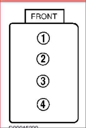

The coil assembly I recently replaced is easy to wire as the unit is all one piece having two coils each running two cylinders and they are all labeled 1, 2, 3 and 4. When facing the engine from the front of the car, I do not know from left to right if the order is 1-2-3-4, or 1-3-2-4. This car actually runs no matter where I put the wires, it does not run well, but I am surprised it can run at all if not in the right order. Please help me solve this problem! Thank you!
Sep 11, 2018 at 2:52 AM
DANNY L
  • 5,648 POSTS
Hello, I am Danny.
I have attached two pictures showing the firing order. Hope this helps and feel free to ask any questions needed.Thanks for using 2CarPros.

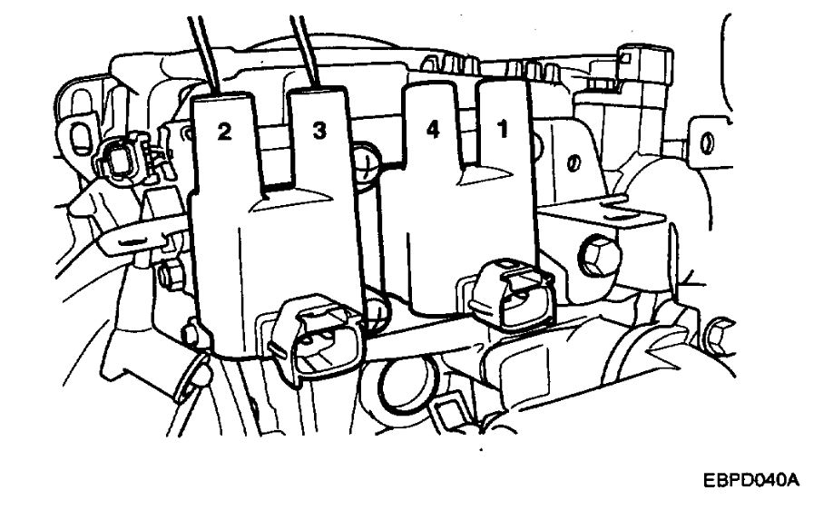

SOPHIE MARIE
Need firing order 1.5 sohc.
Sep 19, 2020 at 7:13 AM (Merged)
Good morning,
I attached the firing order as well as the ignition wire locations. Check out the diagrams (Below). Please let us know if you need anything else to get the problem fixed.

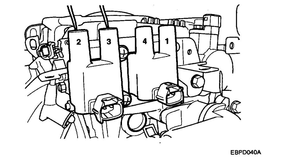

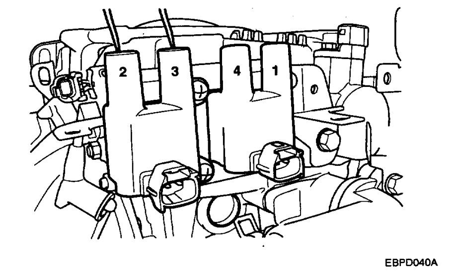

ALBERTCOSGROVE
I came to change plugs and wiring but unplug all wires loll what is the firing order and are they placed 1234 ?
  • 55,224 POSTS
Hello, yes the plug wires go 1234 just as they look on the coil housing
Let me know know how it goes
ALBERTCOSGROVE
Thanks the car works now haha

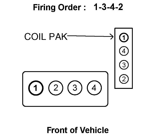

PORSCHA
Four cylinder two wheel drive manual 95,000 miles.
I was not thinking and took off all of the spark plug wires at once. Now I am trying to figure out how they go back on. How do I find out the engine firing order for my car?(1.5 liter engine)
Also, do the spark plug wires have to be in a specific order, like longest to shortest?
BLUELIGHTNIN6
  • 16,542 POSTS
Is this a DOHC or SOHC engine? The length of the wires does not matter as much as the firing order. however, if you do not get them in the right place then they may not reach from cylinder to coil properly.
PORSCHA
It is the SOHC engine.
BLUELIGHTNIN6
  • 16,542 POSTS
1.5L SOHC engine. Firing order: 1-3-4-2. Distributor-less ignition system .

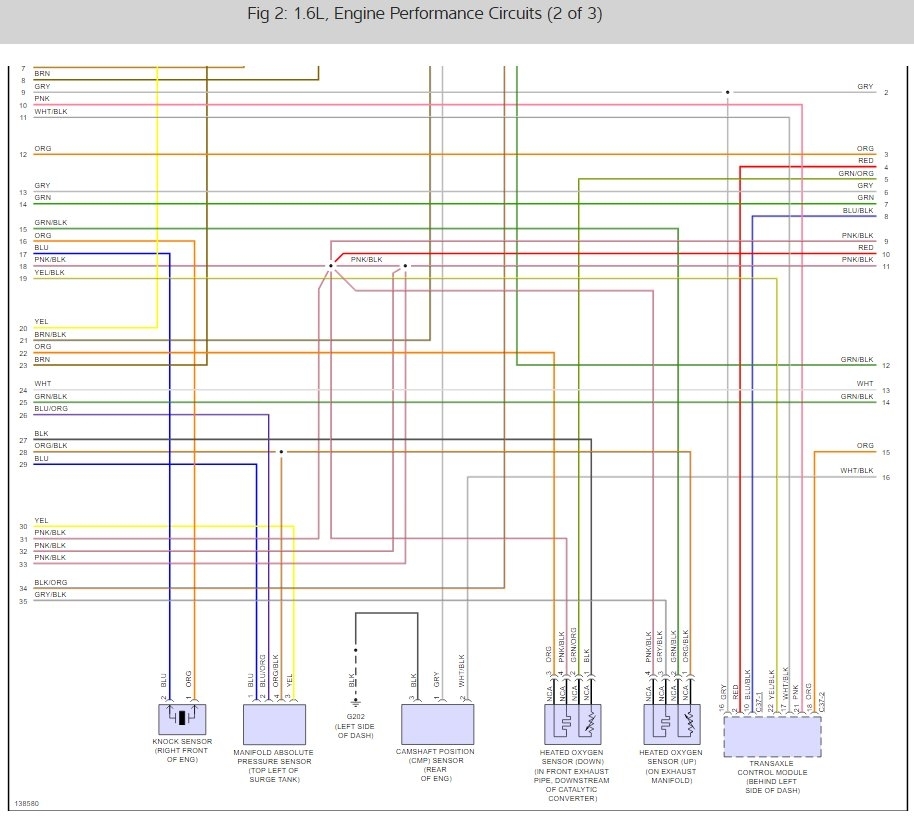

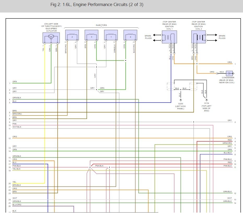

BRYANTARNOLD
Four cylinder front wheel drive automatic
I have had trouble with my engine misfiring so I did the basic tune up repairs. Wires, fuel filter. and that did not work so I took it to a local mechanic to have it diagnosed. They told me the coil was bad and it would be a $250.00 repair. So I decided to do it myself because the part was only $82.00. I changed the old one out and put it back together exactly as I took it apart. The engine still misfires and the check engine light still comes on. I did notice however that the wires seemed to be in the wrong order so I am hoping you give me advice on what I may try next and also a diagram of how the plug wires go and what order they plug onto the coil.
thanks
Sep 19, 2020 at 7:14 AM (Merged)
DOCFIXIT
  • 18,828 POSTS
Hello, Here are some ignition wiring diagrams (below) along with the engine firing order. and a guide to help you do some testing https://www.2carpros.com/articles/how-to-use-a-test-light-circuit-tester and https://www.2carpros.com/articles/how-to-check-wiring
https://images.2carpros.com/forum/automotive_pictures/198357_Graphic_8.jpg
Please let us know if you need anything else to get the problem fixed. Cheers
