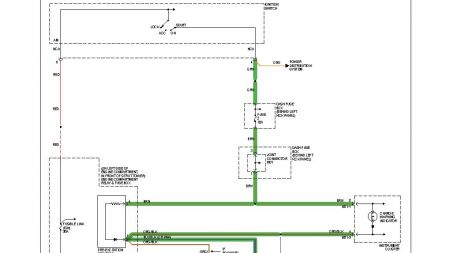

System not charging, new alternator (old one did test bad before replacing it), 100A fusible link in good order. Haynes & Chilton don't make a manual for this model year yet(so I'm told). I've read something about an "IG" wire from the alternator but not sure which of the two in the harness that would be and what exactly to look for. I did check continuity from alternator B+ to battery +, and engine ground to battery -, all looks good at less than 1 ohm. Any advice would be gratefully appreciated.

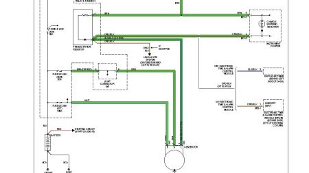

Check these fuses in the dash fuse box behind left kick panel fuse no.2 10amp/fusible link(ECM) 20amp also the 100amp fusible link on the left side of engine compartment in front of strut tower relay and fuse box.
https://images.2carpros.com/forum/automotive_pictures/12900_c1_1.jpg
https://images.2carpros.com/forum/automotive_pictures/12900_c2_1.jpg

Can't read any of the schematic you posted, too grainy.
Fuse #2 is 10amp located behind kick plate - good
100amp fusible link located in front of strut tower - good
Where is the 20amp ECM fusible link?
Can you email the schematic to gferraro@comcast.net
