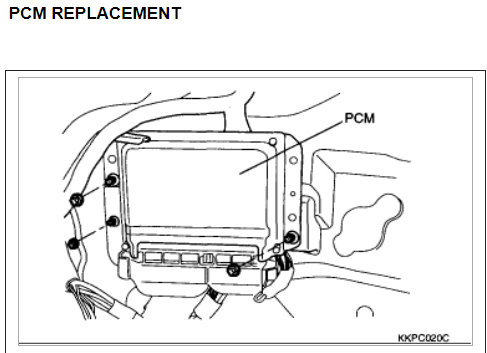

This sounds like a transmission pressure solenoid that is going out and needs to be replaced but to be sure lets run the codes to confirm the failure.
Here are the locations of the solenoids if needed. Sometime codes wont come up for this problem.
Also I have seen where the PCM can fail causing this issue as well.
Oct 30, 2019 at 10:49 AM (Merged)
NANNY
Thank you for taking the time to help me. I thought I would let you know what happened. I took it to a shop and they changed out the PCM for a tune of $450.00 but at least the car is running.
Thanks again!

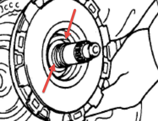

At morning i start the engine and drive for a while the automatic transmission not shifting i think it start at third gear and still until i switch off the engine and start again, then automatic transmission works normal.

check fluid level and have a trans guy scan for codes it may be a seal in cluch pak not working til it heats up

Thank you for your response I check the fluid level its OK but when I remove the Automatic transmission pan I found some metal swarf, then I return the same oil and close the pan again
the mechanic told me that gear number four is worn out but I don't trust him.

itf the metal you found in your pan was just like dusty style but wet then that is normal. if it's larger pieces like small shavings then there is a problem inside and can be a thrust bushing going or bearing. it may be moving to far on shafts causing your problem. to where the seals on the shaft are not holding well. see pic arrows point to seal as an example. if thrust bearings are bad you end up with to much end play in shafts so it skips gears

it's a large pieces like this (-) and no skips gears it's just stuck at number three gear and then not go to four and not going to two gear either until switch off the engine and start again then every thing back to normal.

if it's large pieces then it's gonna be time for a rebuild
