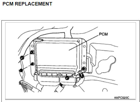

Transmission problem 4 cyl Front Wheel Drive Automatic
When I head out on the highway after about 15 to 20 minutes if I have to slow down for traffic lights or merging on a clover leaf off the highway going down to 30 miles an hour, as the Overdrive transmission shifts down a gear, it stays in this lower gear and as I speed back up to highway speeds the transmission will not shift back into over drive. the RPM climbs to 4000 RPM and I have to pull over and turn the car off. Then restart the motor and the transmission will shift properly again. This goes on till the next time I slow down and the transmission will either ruffly down shift with a jerk or it will shift down but stay hung up again in a lower gear causing high RPM's. It is intermittent as it will not do this on every trip !! what are some possible causes and repairs. Thanks alot need a good reliable car ASAP as I need this car every day.
Oct 30, 2019 at 10:49 AM (Merged)
  • 55,649 POSTS
This sounds like a transmission pressure solenoid that is going out and needs to be replaced but to be sure lets run the codes to confirm the failure.
Here are the locations of the solenoids if needed. Sometime codes wont come up for this problem.
Also I have seen where the PCM can fail causing this issue as well.
NANNY
Thank you for taking the time to help me. I thought I would let you know what happened. I took it to a shop and they changed out the PCM for a tune of $450.00 but at least the car is running.
Thanks again!

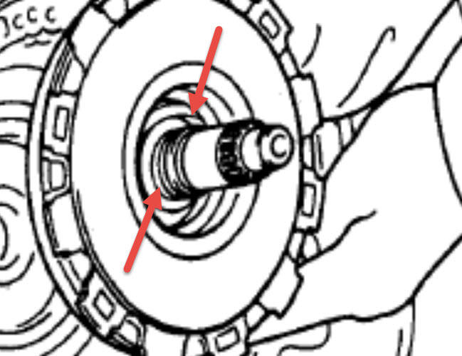

ALROUSAN
At morning i start the engine and drive for a while the automatic transmission not shifting i think it start at third gear and still until i switch off the engine and start again, then automatic transmission works normal.
HMAC300
  • 48,601 POSTS
check fluid level and have a trans guy scan for codes it may be a seal in cluch pak not working til it heats up
Oct 30, 2019 at 10:50 AM (Merged)
ALROUSAN
Thank you for your response I check the fluid level its OK but when I remove the Automatic transmission pan I found some metal swarf, then I return the same oil and close the pan again
the mechanic told me that gear number four is worn out but I don't trust him.
HMAC300
  • 48,601 POSTS
itf the metal you found in your pan was just like dusty style but wet then that is normal. if it's larger pieces like small shavings then there is a problem inside and can be a thrust bushing going or bearing. it may be moving to far on shafts causing your problem. to where the seals on the shaft are not holding well. see pic arrows point to seal as an example. if thrust bearings are bad you end up with to much end play in shafts so it skips gears
ALROUSAN
Dear Sir
Thank you
it's a large pieces like this (-) and no skips gears it's just stuck at number three gear and then not go to four and not going to two gear either until switch off the engine and start again then every thing back to normal.
HMAC300
  • 48,601 POSTS
if it's large pieces then it's gonna be time for a rebuild
