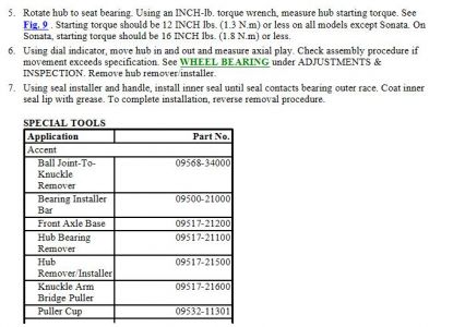

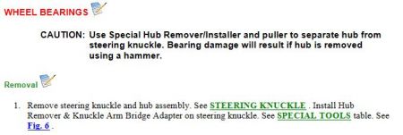

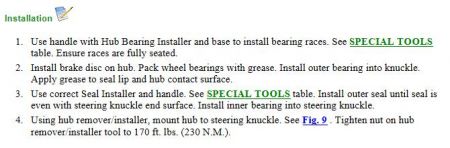

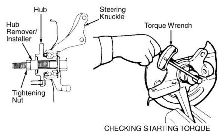

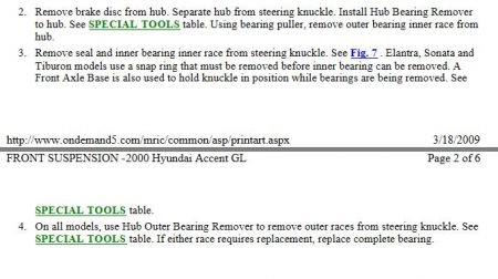

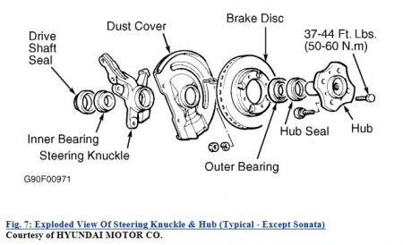

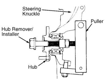

how do remove the bearing hub to get to the bearings? (front)
Mar 14, 2009 at 11:26 AM
KHLOW2008
  • 41,814 POSTS
Hi Sean Horner, Hope the following works.
https://images.2carpros.com/forum/automotive_pictures/192750_WheelBrg00Accent01_1.jpg
https://images.2carpros.com/forum/automotive_pictures/192750_WheelBrg00Accent02_2.jpg
https://images.2carpros.com/forum/automotive_pictures/192750_WheelBrg00Accent03_1.jpg
https://images.2carpros.com/forum/automotive_pictures/192750_WheelBrg00Accent04_1.jpg
https://images.2carpros.com/forum/automotive_pictures/192750_WheelBrg00Accent05_1.jpg
https://images.2carpros.com/forum/automotive_pictures/192750_WheelBrg00Accent06_1.jpg
https://images.2carpros.com/forum/automotive_pictures/192750_WheelBrg00Accent07_1.jpg
