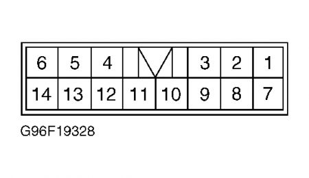

1998 Hyundai Accent 4 cyl Front Wheel Drive Automatic
does anyone know where the fuse or fuseable link or both for the overdrive would be ! thanks

OVERDRIVE SWITCH Disconnect electrical connector for overdrive switch and note switch terminal identification. See Fig. 26 , Fig. 27 or Fig. 28 . Overdrive switch is mounted on driver's side of gearshift lever. Depress overdrive switch to ON position. Using DVOM, ensure continuity exists between terminals No. 1 and 2. Depress overdrive switch to OFF position. Ensure continuity exists between terminals No. 1 and 3. Replace overdrive switch if continuity is not as specified.
https://images.2carpros.com/forum/automotive_pictures/266999_od_1.jpg
