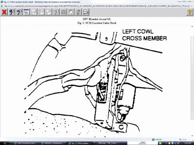

Have you scanned for codes yet? should have set a code if there is no O/D...Get them read, OBDII scanners can be had for 30.00 to 40.00 dollars U.S. Then post the code(s) There is also a modified trans control module for your year, all Hyundai's are covered und the TSB for this...the reference nuber is: 99-40-010 And it should fix the overdrive problem! The new part number is 95440-22691
https://images.2carpros.com/forum/automotive_pictures/62217_TCM_3.jpg
Not the best picture, but it's located on the left underside of the dash...left of the brake pedal...

I took out the overdrive button and broke it.. so i ordered a new one, and replaced it just because I broke the other one and Wala! it was working great again! - amazing how one little electrical switch / button can trigger something like that!
Thanks for your input Merlin!
