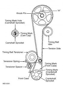

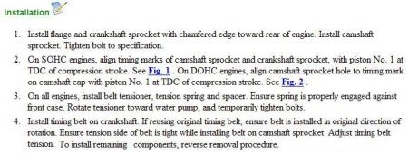

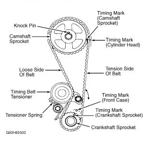

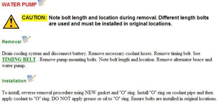

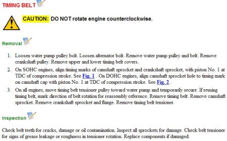

my water pump bearings have gone bad I need step by step directions to remove my water pump and put the new water pump in

FIG. 1
FIG. 2
