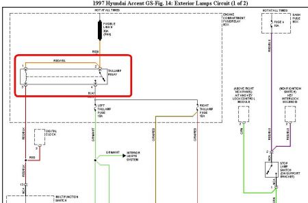

JUST PARKED UP AND CAN NOT TURN OFF SIDELIGHTS AT FRONT EVEN WITH KEY REMOVED AND LIGHT ALARM DOES NOT SOUND ALSO CLICKING SOUND COMMING FROM FUSE BOX UNDER BONNET. THANKS

https://www.2carpros.com/forum/automotive_pictures/55316_97accenttail_1.jpg
Check your faulty tail light relay inside the engine compartment relay box.
