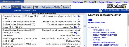

My problem I'm struggling with is every time I start the car, and it is cold, the choke comes on. No problem with that, but, my car revs very high. The revs only come down once the engine is on temperature.
It seems as if the choke is working with the engine coolant. Could there be a temp sensor that has gone faulty perhaps? Please, could anybody help me?

See below
https://images.2carpros.com/forum/automotive_pictures/12900_cts_49.jpg

Thank you very much. I take it that the 1.5L & 1.3L uses the same temp sensor relating to the choke? If I had any point, I would give it to you! Many thanks again!!
