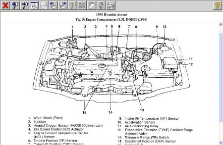

The needle on the temperature gauge goes crazy (up and down)intermitently. I know the car temperature is OK (not over heated). What is happening? How can it be fixed? Thanks for your attention.
Mar 11, 2008 at 4:18 AM
  • 75,992 POSTS
Test the engine coolant temperature sensor and its wiring. Its located below no.5
