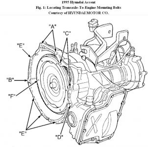

1995 Hyundai Accent Front Wheel Drive Manual 145000 miles
where is the starter located,diagram please,how to replace

Hi natben, Starter is located at end of battery positive cable. In diagram, the starter bolts are attached to " C " on the transmission, under the manifold.
https://images.2carpros.com/forum/automotive_pictures/192750_Starter95AccentFig01_1.jpg
Sorry I could not find any other diagrams to show you. STARTER Removal & Installation Disconnect negative battery cable. Remove speedometer cable and shift cable. Disconnect starter motor connector and wire. Remove starter. To install, reverse removal procedure.
