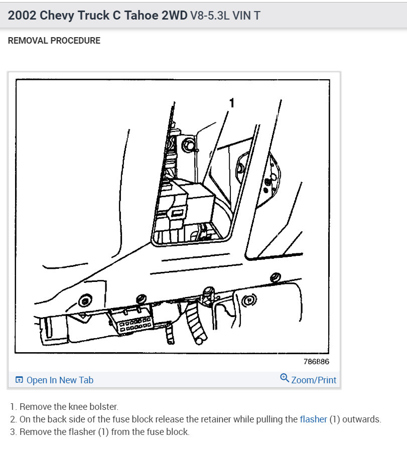

My turn indicators sound like they have been turned on even when not in use. all bulbs intact and work. looked for new part- discount at GM dealer- pulled one from wreck still has "hyper flashing" sound. also tried other new replacement parts from O'Reilly and Napa and AutoZone all failed to install correctly.
Will I need a whole new flasher wiring system?

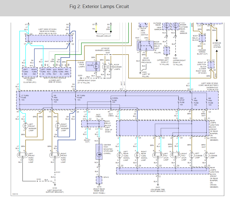

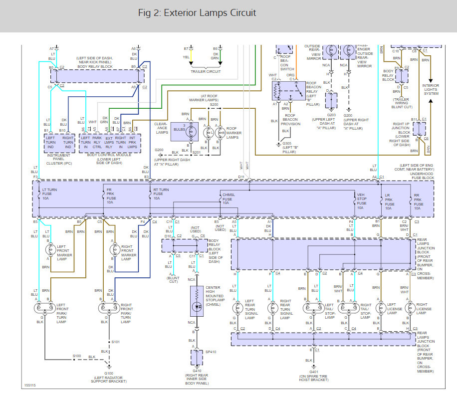

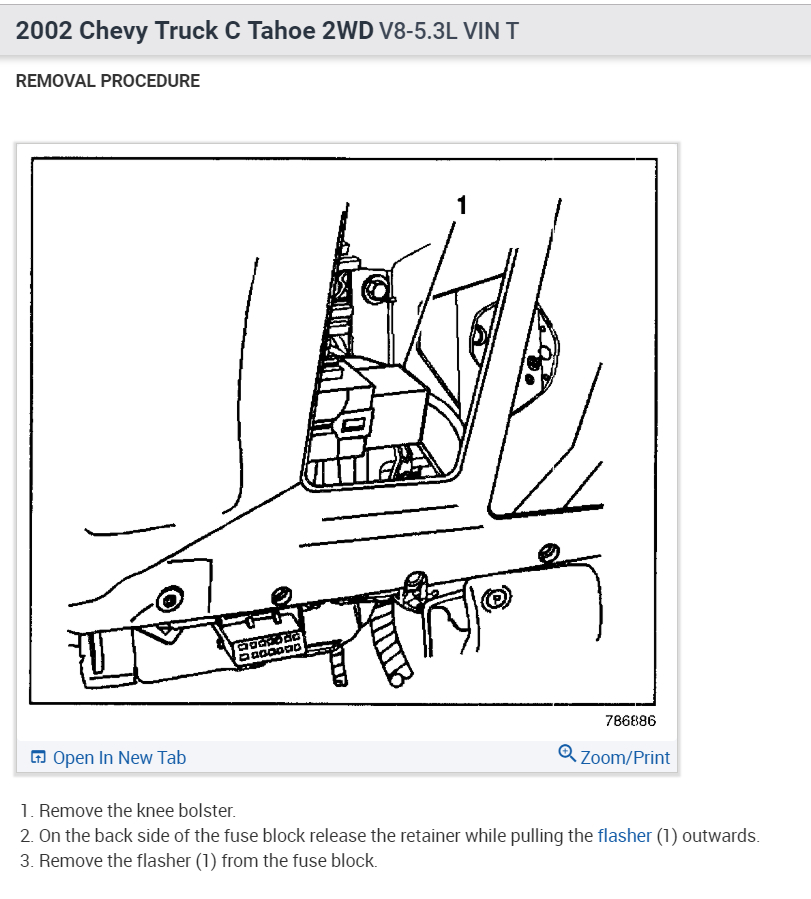

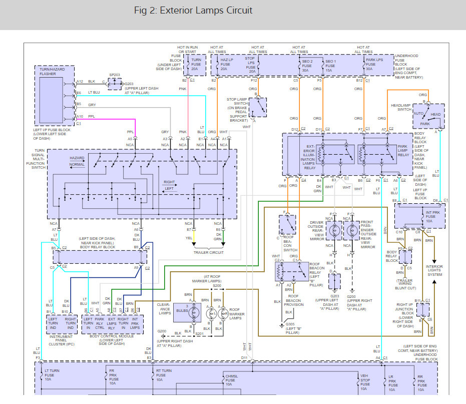

It sounds like you have a bad ground. here is a guide to help you test the ground circuits and the blinker wiring diagrams and flasher location so you can see how the system works.
Check the grounds for the bulbs. Check out the diagrams (below). Please let us know what you find. We are interested to see what it is.
