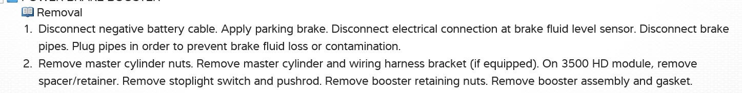

Do you have a video on replacing the hydroboost?

I don't think we do it's pretty simple just hook the lines up right and p/s pump works it.

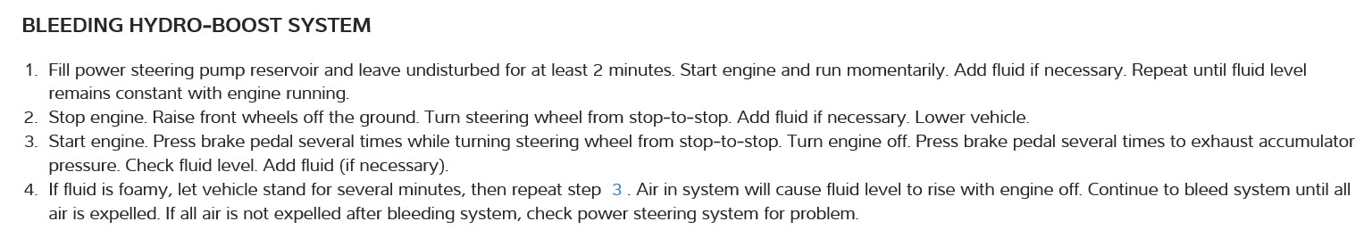

see pics for instructions and follow bleeding procedure. install is basically reverse of removal.

OK. Thanks. Might try to do it later today.
