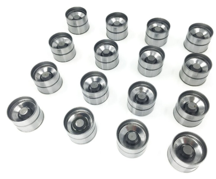

Where are the lifts and how do you remove or clean?
1999 DAEWOO LANOS
140,000 MILES • 1.6L • 4 CYL • 2WD • AUTOMATIC
GEOFF T
Hydraulic lifters.
Apr 16, 2023 at 6:26 PM
BORIS K
  • 836 POSTS
What is the issue with your engine?
Noisy valve lifters?
Valve train noise is often caused by bad or low engine oil or sludge/carbon build up.
A good video explaining noisy valve lifters:
https://youtu.be/QfSDx5Odh3o
A good video showing hydraulic valve lifter change on a GM, Opel engine. Very similar to your engine:
https://youtu.be/x9FnwIovN9I

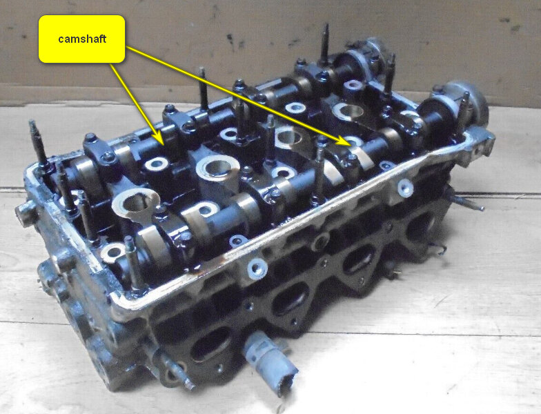

The hydraulic valve lifters are located inside the cylinder head underneath the camshafts.
Your vehicle is equipped with a 1.6L 16V DOHC engine.
Meaning dual overhead camshafts with 16 valves, therefore 16 valve lifters.
See image 1+2 below.

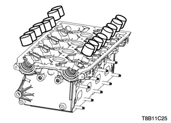

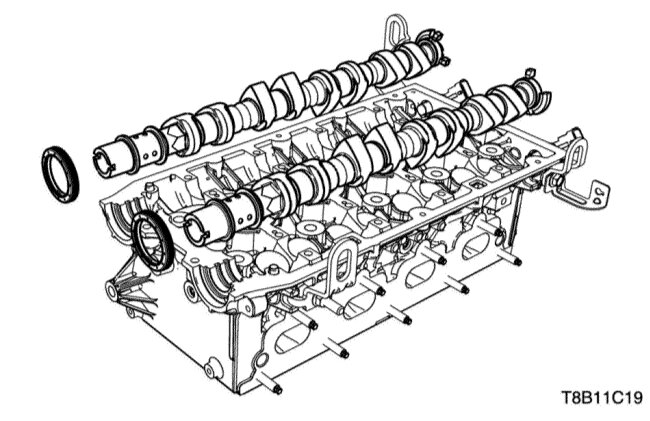

To access these, you will need to remove both camshafts.
See image 3+4
