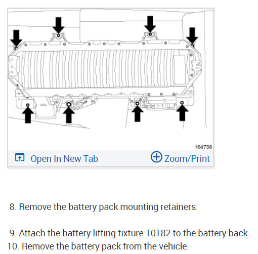

Does the new hybrid battery lose its charge quickly like the old one? Also be careful charging/checking the hybrid battery, it is high voltage, I would park the car outside until the problem is fixed as well.
The U1123 code indicates a loss of communication with the Hybrid Control Processor (HCP).

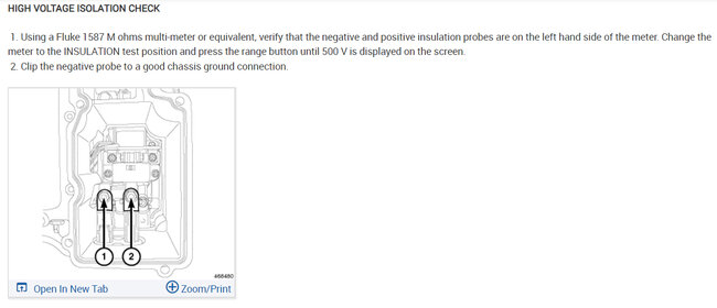

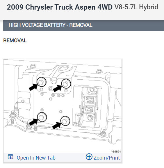

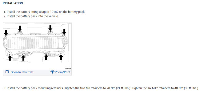

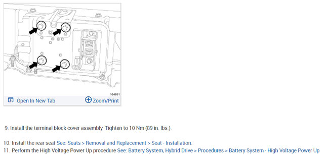

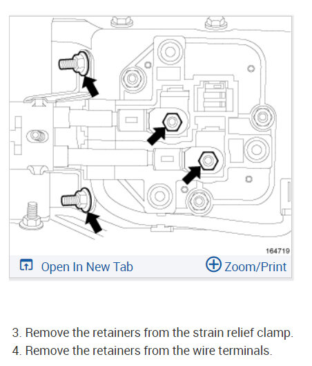

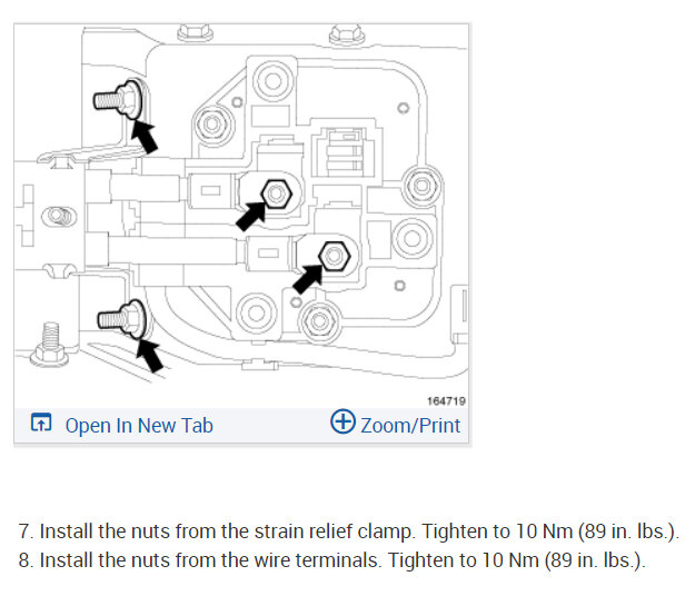

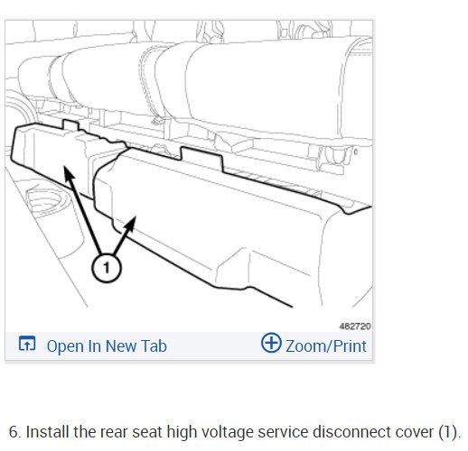

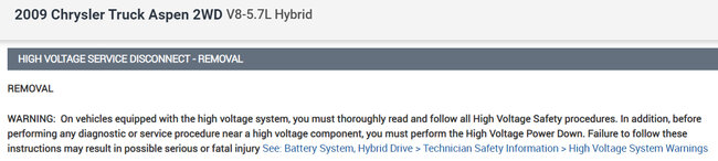

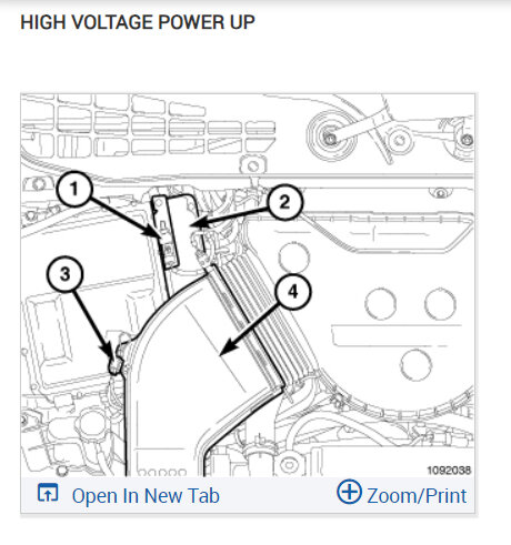

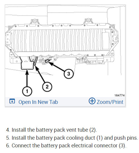

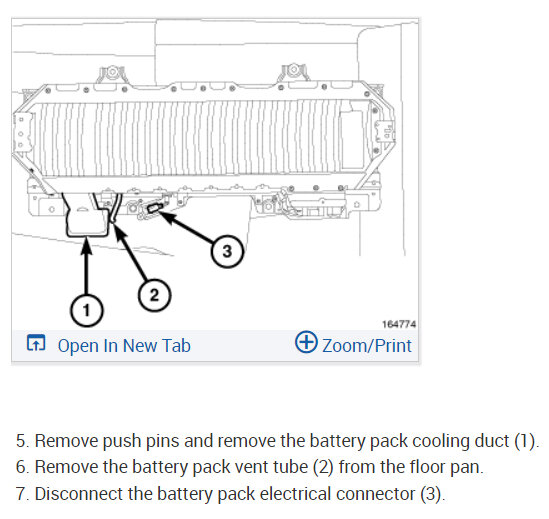

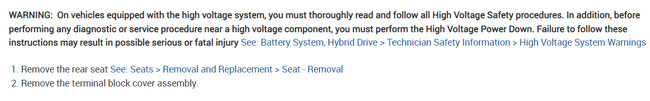

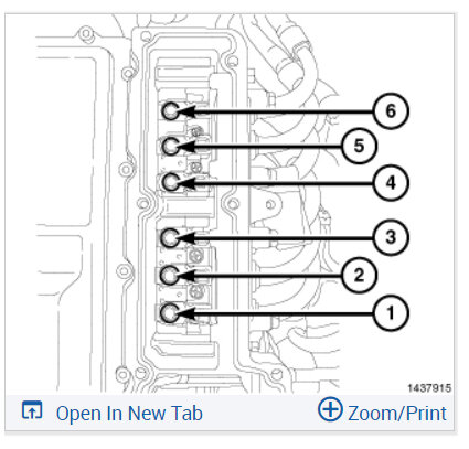

Anytime you replace the hybrid battery you need to do a "High Voltage Power Up" procedure. Here is how to change the hybrid battery out correctly and how to do the High Voltage Power Up" procedure and how to do a high voltage isolation test. Wear the appropriate safety attire to avoid getting shocked, thick rubber gloves etc. Also, if you have not already taken a safety course for hybrid battery handling. Check out the images (below). Please upload pictures or videos in your response to any problems so we can see what to help you with.

Thanks Ken. The car is at my brother’s place where the hybrid was installed. I’ll check with him regarding the charge on the new hybrid battery. And I’ll pass this information on to him and see if we get any results. I don’t know if the installer followed the steps, you mentioned above but I’ll find out.

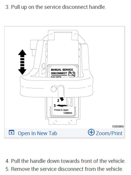

So, we tested the hybrid battery with a voltmeter at the posts under the seat. With the main cables that come from the transmission disconnected and the safety switches connected we only got a .03V reading. The manufacturer said maybe something isn’t connected inside the battery. He is positive the 40 cells are new and charged from Toyota. When read the information on “power up” and isolation codes but don’t understand what exactly it accomplishes. I have the same information on my E-manual for this car.

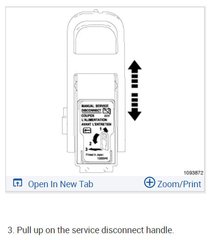

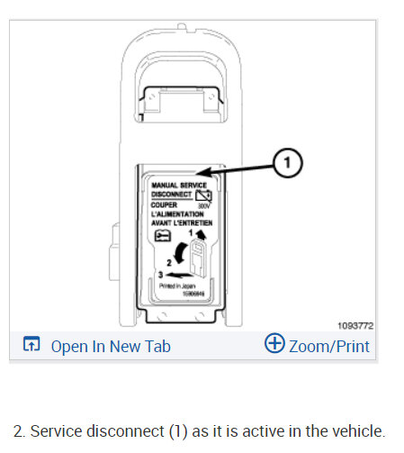

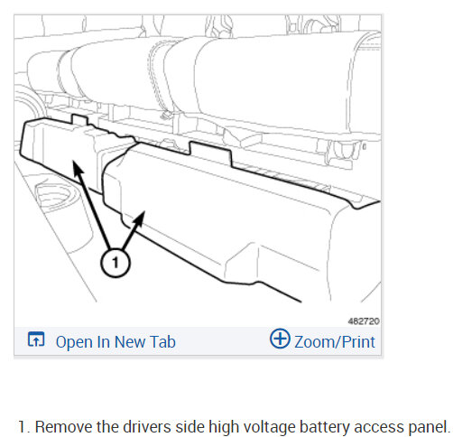

If the post are reading .03 volts at the main power lugs, then something is wrong with the battery or the service switch is engaged, here are the instructions for the switch service mode. Check out the images (below). Please let us know what happens.

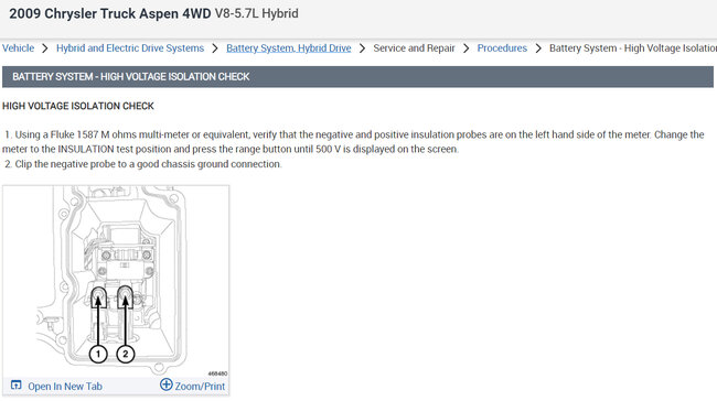

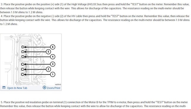

I would think if this battery does not have voltage in the same environment the old battery did the battery is defective. Here is how to do a battery isolation test. Check out the images (below). Please let us know what happens.

I’ve looked at this battery isolation test and don’t really understand what it does. Can you explain that to me please?
Jul 1, 2024 at 4:52 AM
  • 55,766 POSTS
I found this video to check out, but it sounds like the battery is no good, let me know how many volts you get.
https://youtu.be/apFEk8xsYas?si=qqxV4cGJ51KOHUF8
Please go over this guide and get back to us.
