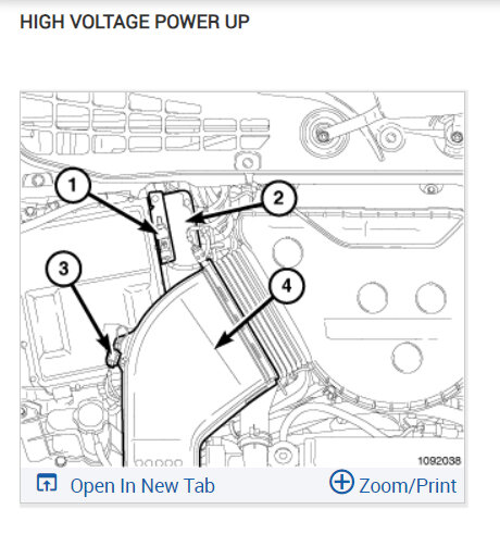

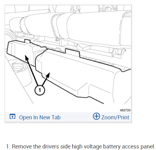

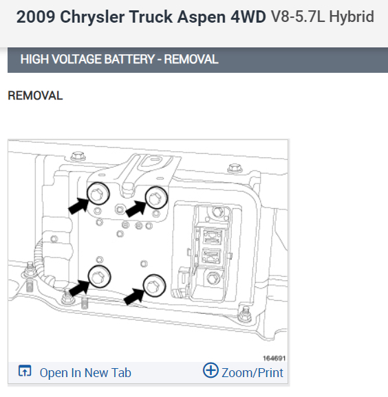

I bought the vehicle listed above Hybrid to replace a previous one I lost in a collision. I bought it "as is" from a dealer that said it had run fine until it sat a long time and developed a "hybrid battery fault" and he could not sell it. I ran codes and got a U1123. I bought a new 12V battery and installed it. When I tried to start it, the engine would jump just a bit each time but would not start. I bought a 430V converter and attempted to charge the hybrid battery for over 18 hours. I attached the leads to the two posts under the driver's side passenger seat. It only charged up to 114V but quickly dropped after I removed the converter. When I tried to start it, the engine jumped with more force, but it did not start. I had a new hybrid battery installed by Hybrid To Go but it still won't start and the navigation radio display says, "charge insufficient to start vehicle, leave key in ignition and connect jumper cables". This message is referring to the Charge Assist Mode for the hybrid battery. We tried to charge it according to the manual's instructions but still have the message. The owner of the Hybrid battery company insists the battery is new with Toyota cells inside. Any thoughts?

The U1123 code indicates a loss of communication with the Hybrid Control Processor (HCP).

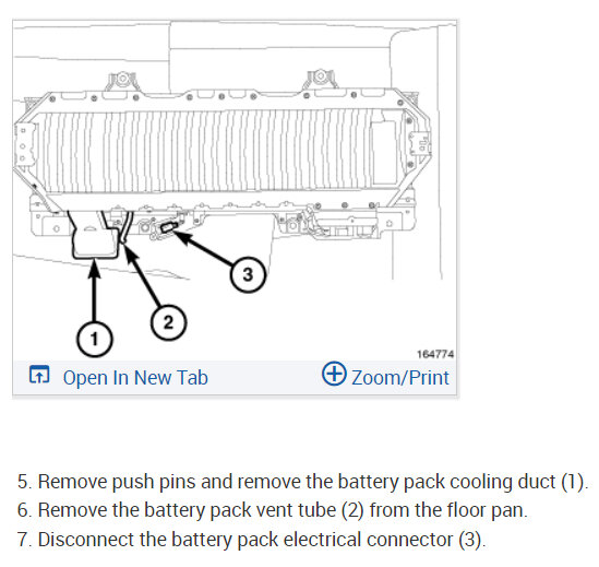

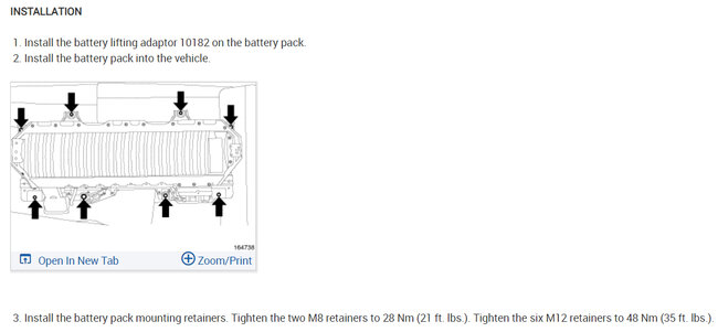

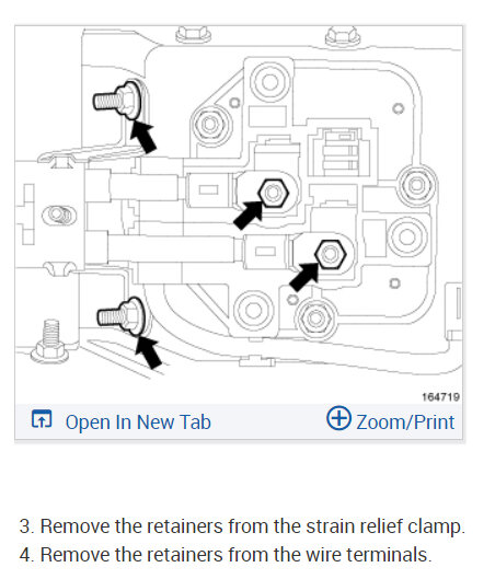

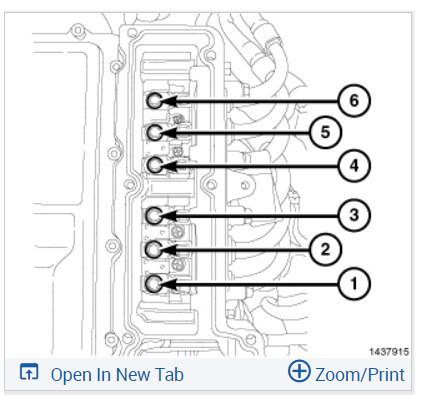

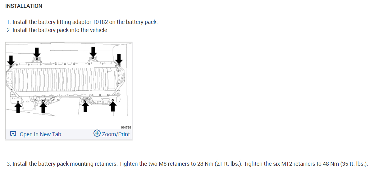

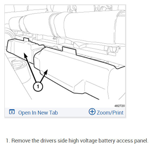

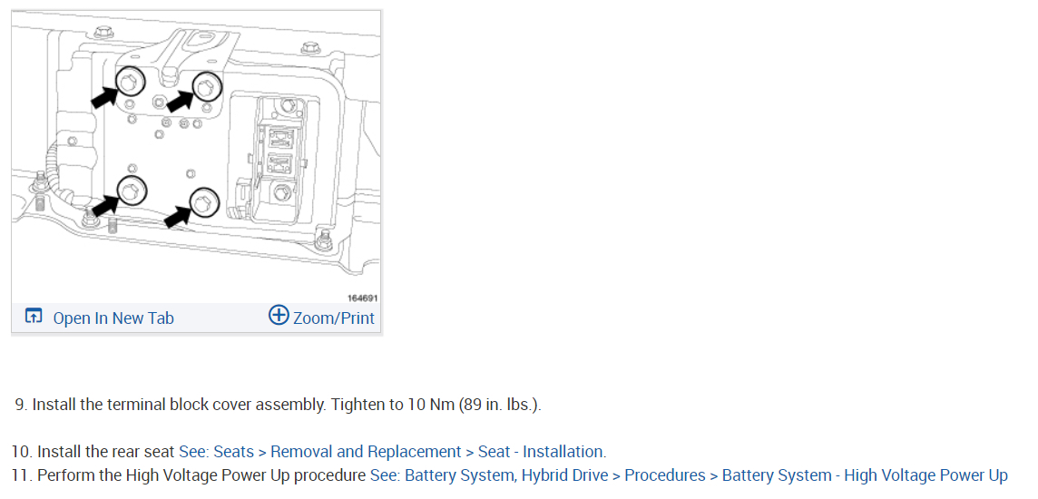

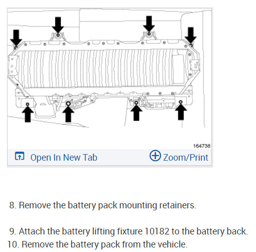

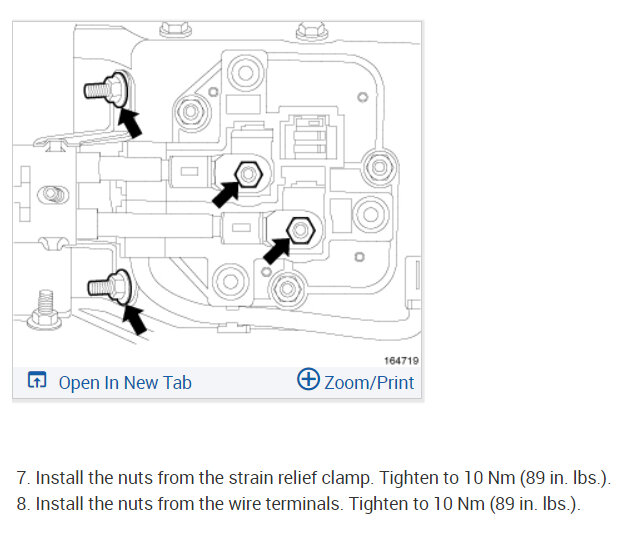

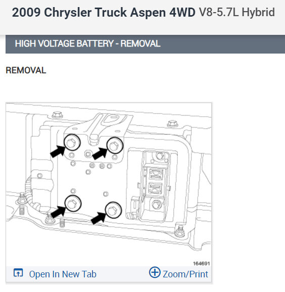

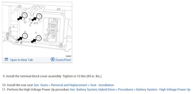

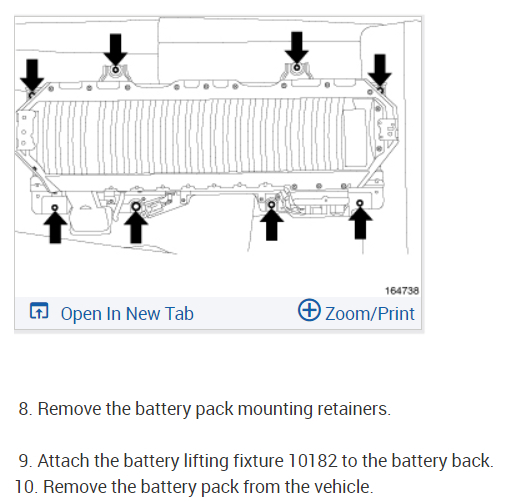

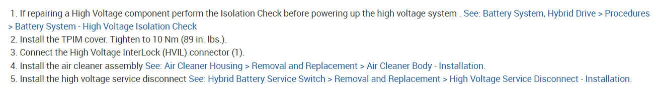

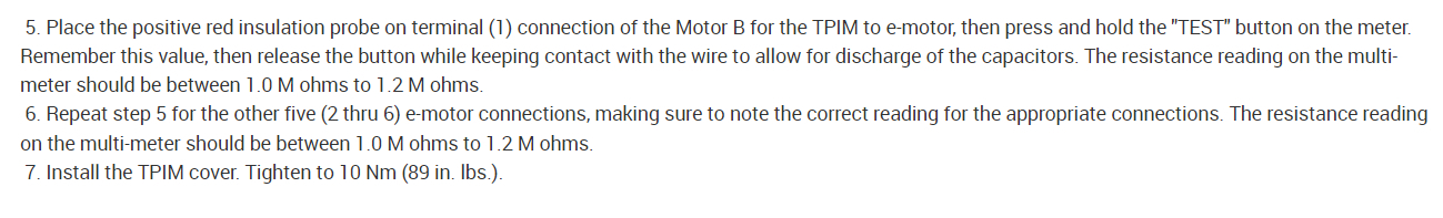

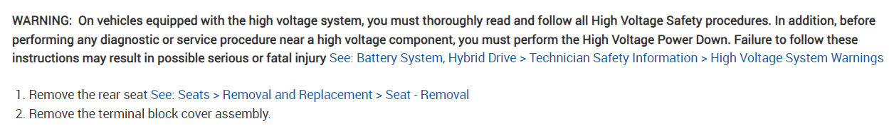

Anytime you replace the hybrid battery you need to do a "High Voltage Power Up" procedure. Here is how to change the hybrid battery out correctly and how to do the High Voltage Power Up" procedure and how to do a high voltage isolation test. Wear the appropriate safety attire to avoid getting shocked, thick rubber gloves etc. Also, if you have not already taken a safety course for hybrid battery handling. Check out the images (below). Please upload pictures or videos in your response to any problems so we can see what to help you with.

Thanks Ken. The car is at my brother’s place where the hybrid was installed. I’ll check with him regarding the charge on the new hybrid battery. And I’ll pass this information on to him and see if we get any results. I don’t know if the installer followed the steps, you mentioned above but I’ll find out.

So, we tested the hybrid battery with a voltmeter at the posts under the seat. With the main cables that come from the transmission disconnected and the safety switches connected we only got a .03V reading. The manufacturer said maybe something isn’t connected inside the battery. He is positive the 40 cells are new and charged from Toyota. When read the information on “power up” and isolation codes but don’t understand what exactly it accomplishes. I have the same information on my E-manual for this car.

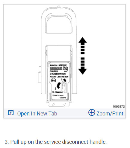

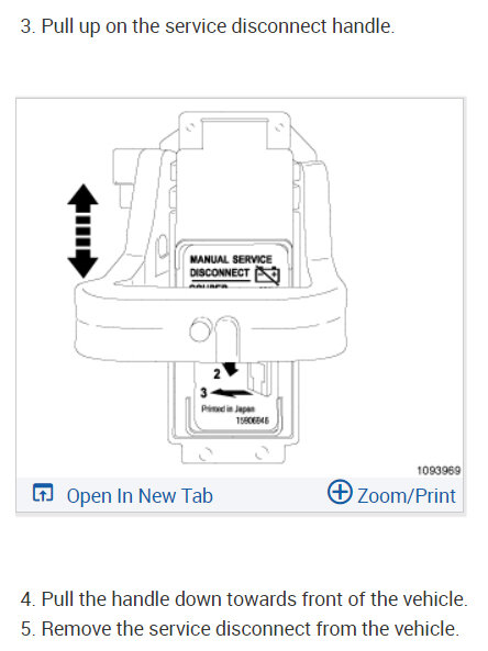

  • 55,433 POSTS

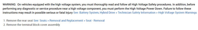

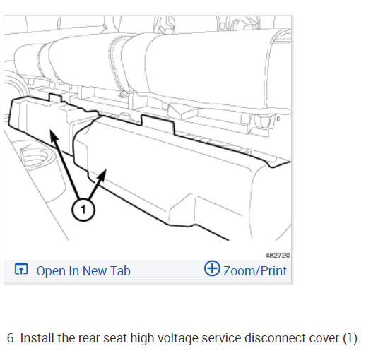

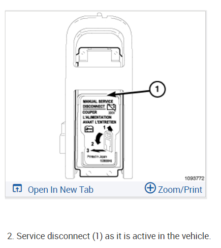

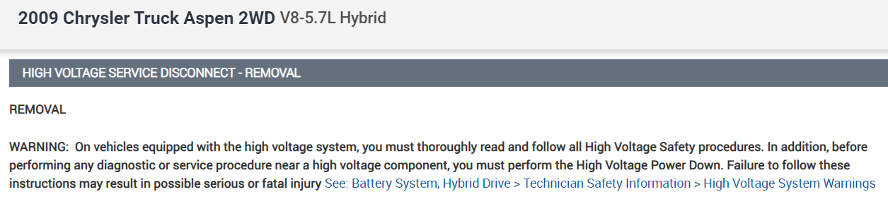

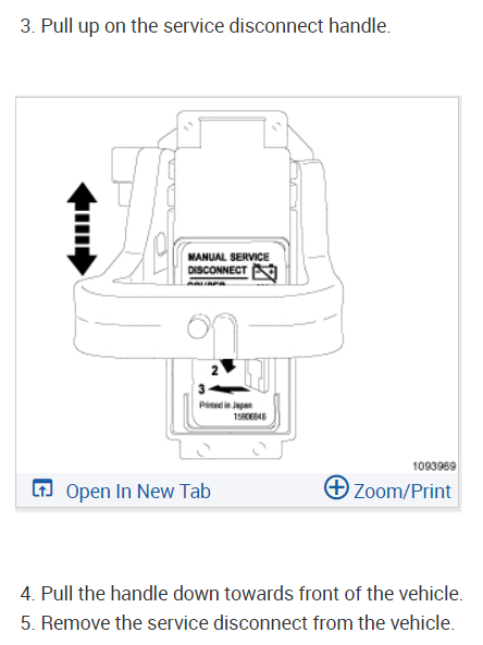

If the post are reading .03 volts at the main power lugs, then something is wrong with the battery or the service switch is engaged, here are the instructions for the switch service mode. Check out the images (below). Please let us know what happens.

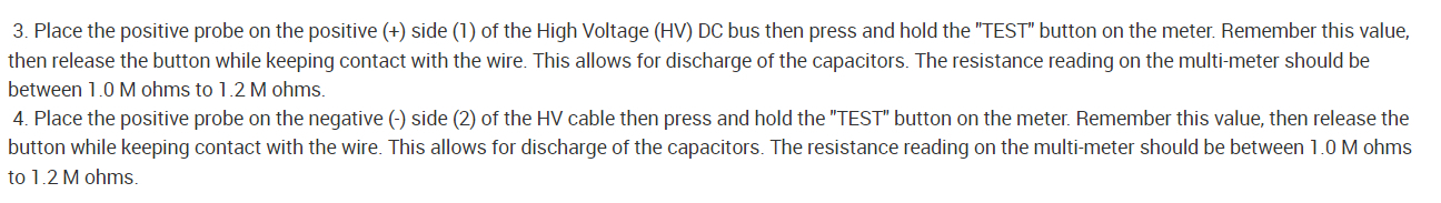

  • 55,433 POSTS

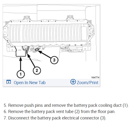

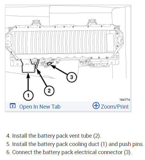

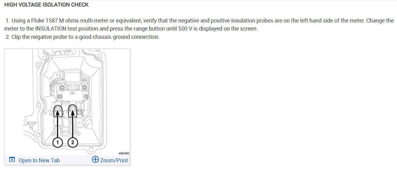

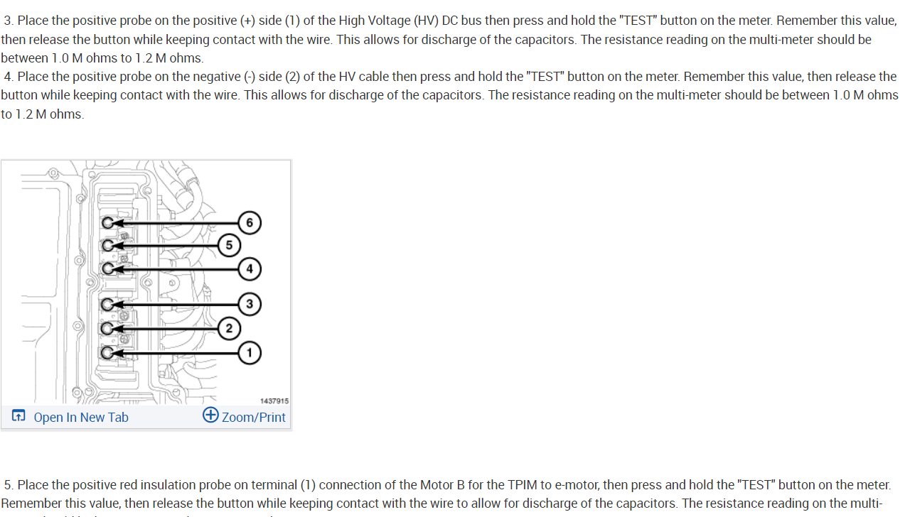

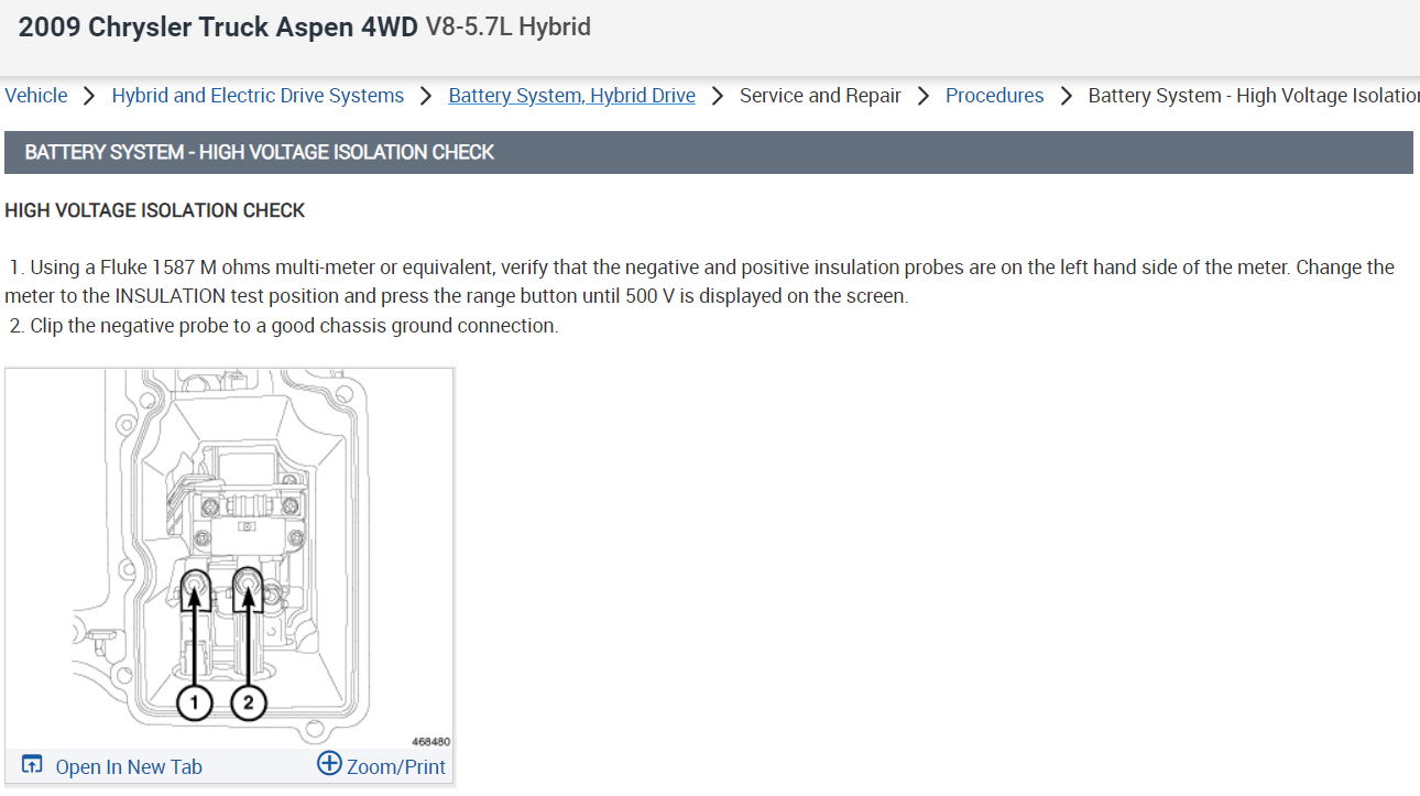

I would think if this battery does not have voltage in the same environment the old battery did the battery is defective. Here is how to do a battery isolation test. Check out the images (below). Please let us know what happens.

  • 9 POSTS
I’ve looked at this battery isolation test and don’t really understand what it does. Can you explain that to me please?
Jul 1, 2024 at 4:52 AM
  • 55,433 POSTS
I found this video to check out, but it sounds like the battery is no good, let me know how many volts you get.
