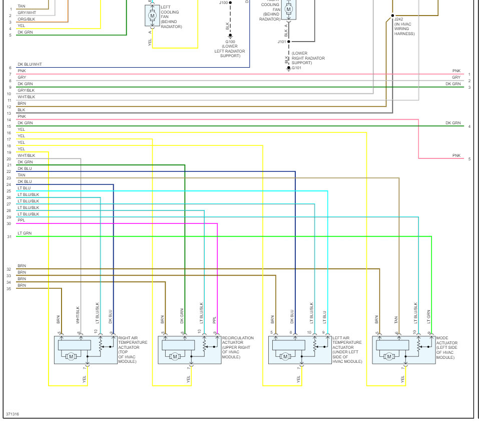

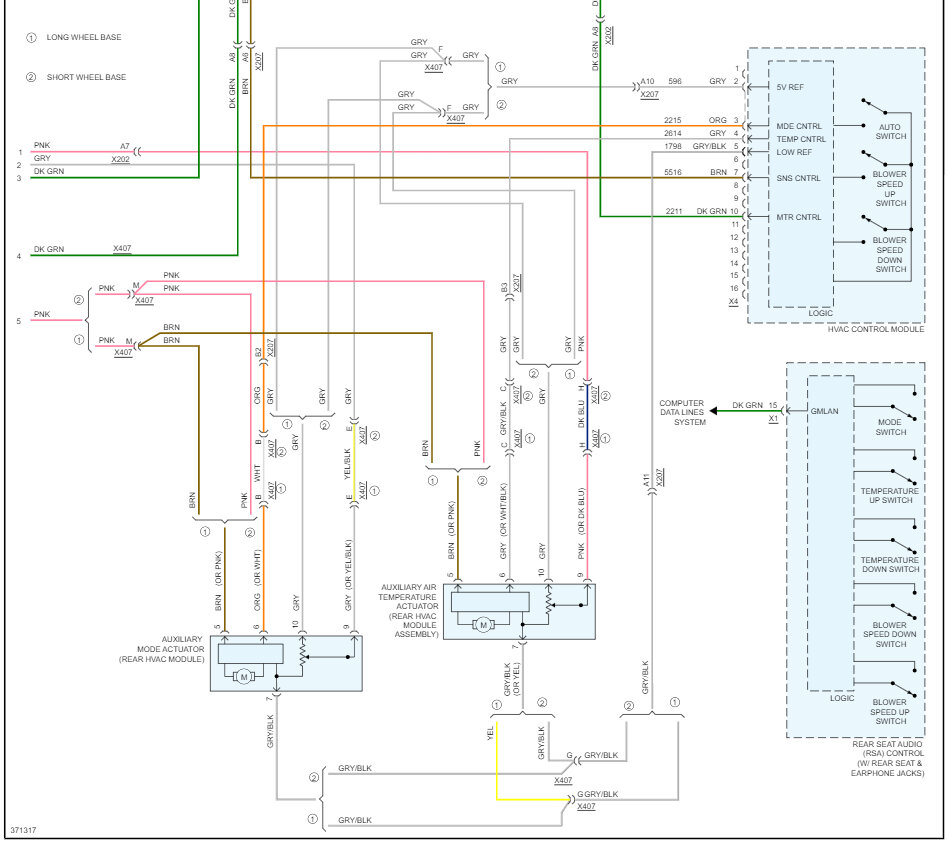

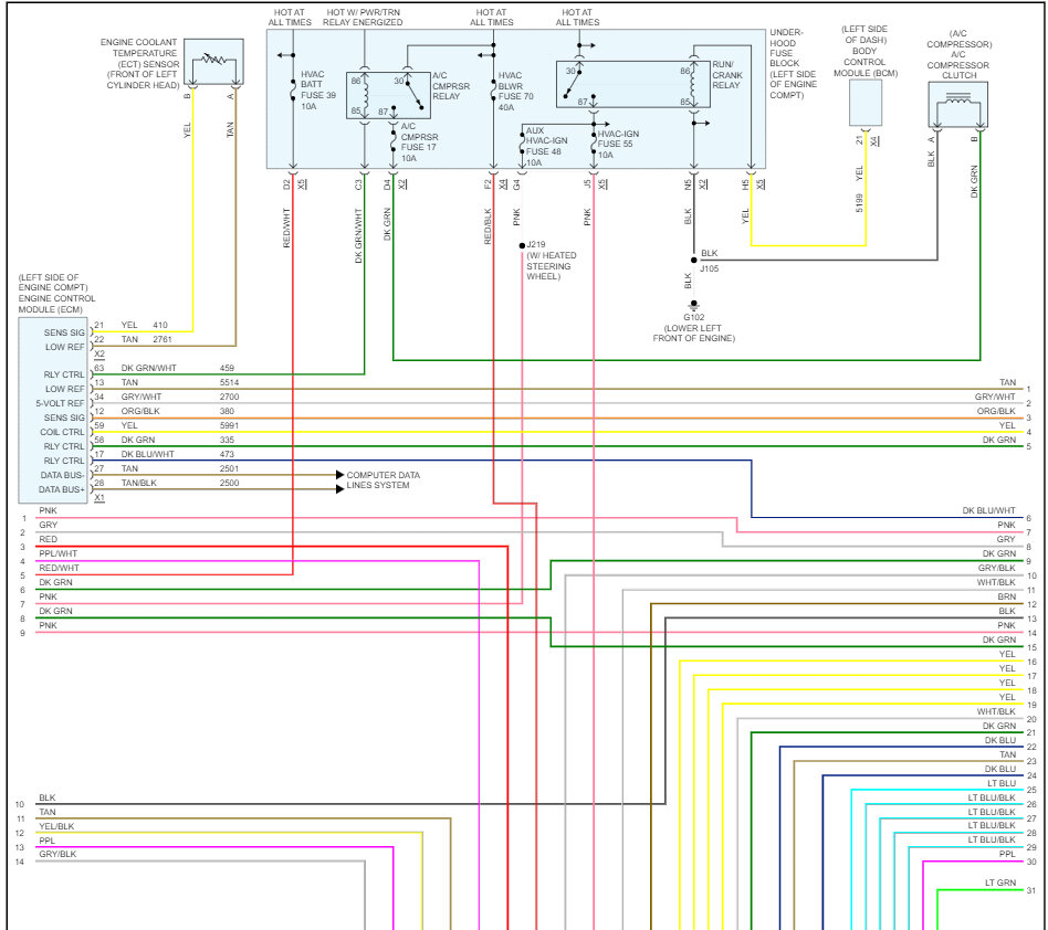

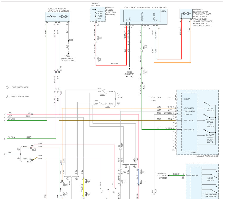

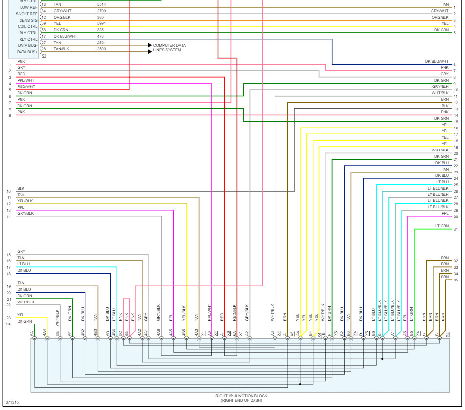

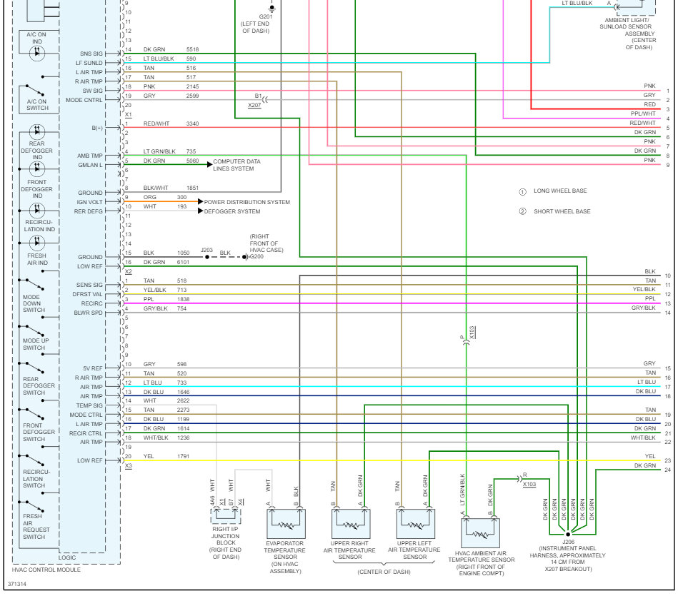

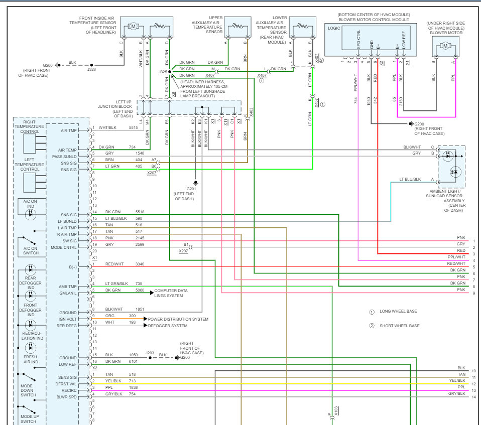

Diagnosing no front HVAC blower motor. I am looking for HVAC wiring diagram for the vehicle listed above. The control voltage wire, is it fused? Getting voltage to blower motor control module. no voltage out to motor. Module is new. Motor is new.
Sep 4, 2023 at 11:56 AM
  • 55,423 POSTS

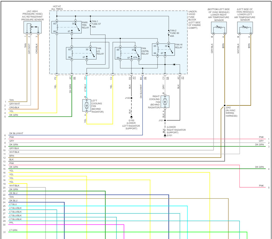

It sounds like you have a bad ground G200 right in front of the HVAC case. Here is a guide that can help, and I have included the HVAC wiring diagrams so you can see how the system works and which wires to test.
