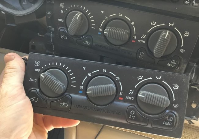

What should I look at next to solve this? I'm getting desperate as this morning was cold and snow (already!) and my feet were frozen by the time I got to work. I included a picture of the control panel in case that helps to see which HVAC I'm dealing with.

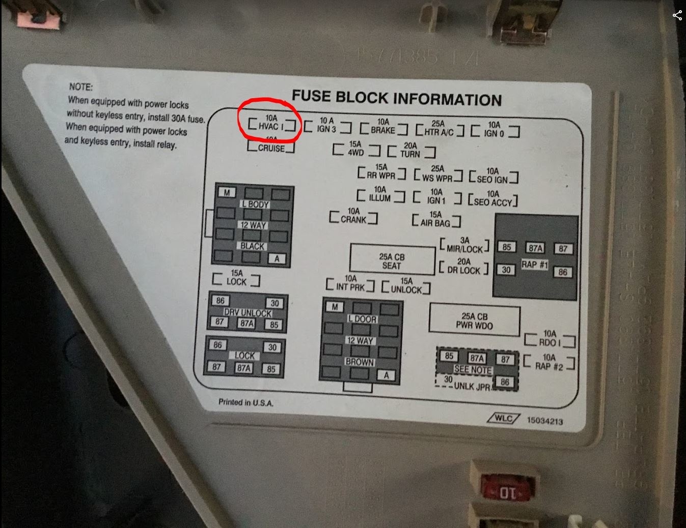

Well, I think I followed the steps. Here's what I did:
Turned off car.
Disconnected the car battery.
Removed the fuse in the picture.
Reconnected battery.
Reinstalled fuse.
Turned car to on position.
I heard actuators moving but there is no change. The blend door still does not open.
Did I pull the right fuse? It's from the box left of the steering column.
Thanks for your help and patience.
Sep 8, 2020 at 12:10 PM

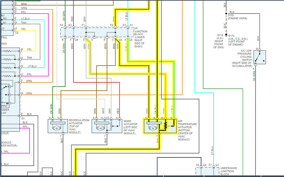

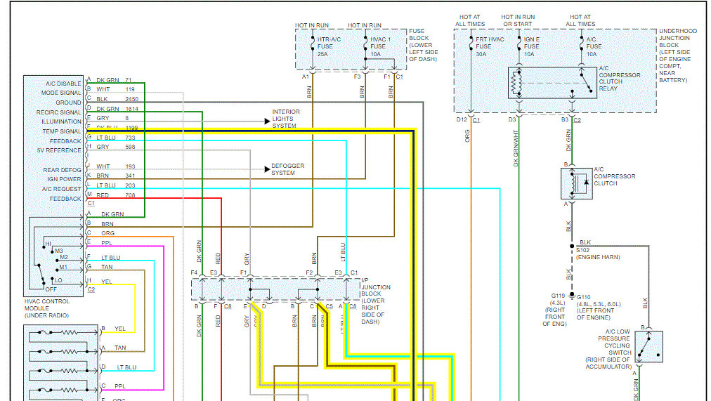

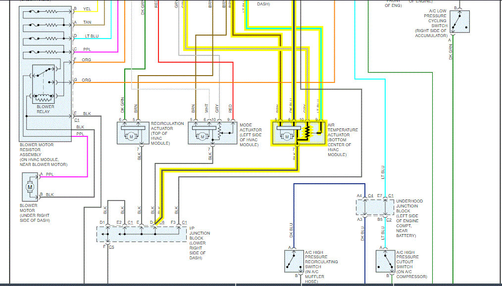

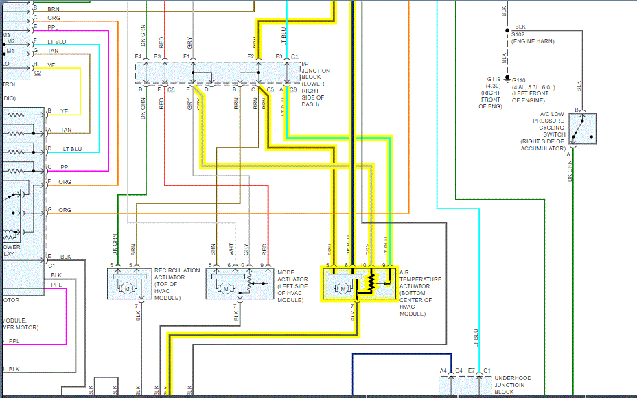

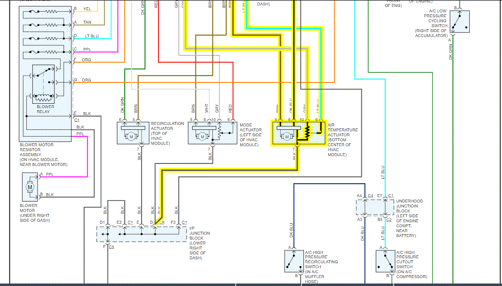

Okay, yes you did.
We need to test the voltages at the actuator to see if it is a wiring issue or a control head issue.
I attached the wiring diagram below.

I do have a voltmeter but must admit, I've not used it much. I'm not sure what I am supposed to check or how to use the diagrams you sent. Sorry to be so inexperienced. I appreciate your patience.
Do I need to pull the HVAC controls out of the dash to get the what needs to be tested?
Sep 9, 2020 at 9:57 AM
No, this needs to be done right at the actuator connector.

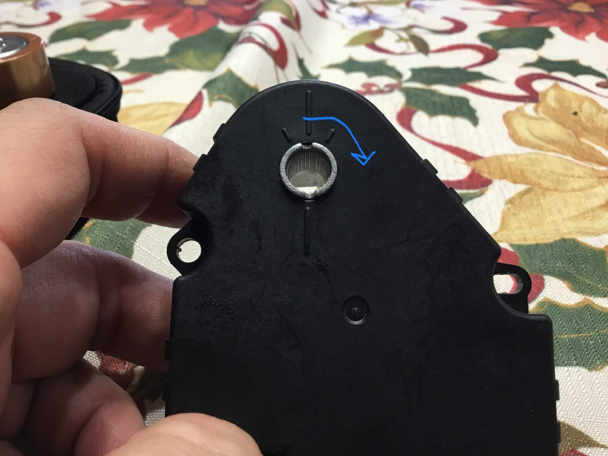

  • 21 POSTS
When I plug it in and then turn the car on it only goes one direction. It does not go the opposite. I’m guessing it’s not reacting to The setting but simply to bring plugged in and that the problem is elsewhere. I have nit iced the back lighting on the HVAC controls are only working on half of each dial. Could this be a clue? Could it be a bad control module?
Sep 10, 2020 at 8:45 AM
MCKAYABROWN
  • 21 POSTS
This arrow shows the only direction of travel.

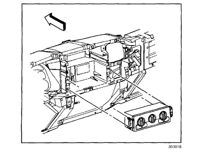

Yes, this sounds like the control head.
I attached a picture and the procedure for you.
I also attached a picture of the part for you as well.
1. Remove the instrument cluster trim plate bezel.
2. Remove the instrument panel storage tray.
3. Remove the inflatable restraint module switch from the instrument panel. Refer to Inflatable Restraint Instrument Panel Module Replacement in Restraint Systems.
4. Remove the HVAC control assembly.
4.1.Release the retaining tabs.
4.2.Pull the control head out of the instrument panel carrier.
5. Disconnect the electrical connectors from the HVAC control assembly.
Sep 10, 2020 at 9:10 AM

I replaced the control module and the lights on it are working. I see now though that the lights on the stereo are now not fully illuminating. And the door does not open even with a new actuator. Any other ideas? Is the stereo an indicator of sorts?

Sep 11, 2020 at 5:41 AM

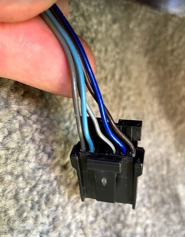

Okay, turn the key to the on position and remove the connector at the actuator.
Check the brown wire for battery voltage.
Sep 11, 2020 at 5:49 AM
MCKAYABROWN
  • 21 POSTS

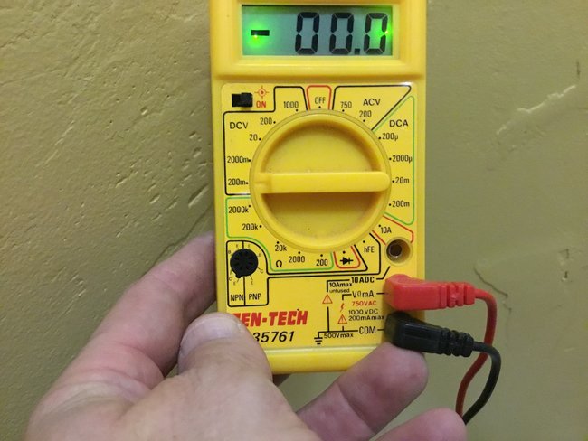

How exactly do I do that? What setting should I have on the voltmeter? This is how I had it set. When I touch the red probe to the brown wire the volt meter goes to .4 and the drops back to zero.
Sep 11, 2020 at 6:02 AM
Put the setting on 20.
Black lead to a good steel body ground and the red lead to the brown wire.
I posted a guide for you a ways back on how to use a voltmeter. You should take a little time to read the guide.
Sep 11, 2020 at 6:16 AM
MCKAYABROWN
  • 21 POSTS
Thanks for the guide. I also reviewed another online. I supposed my lack of confidence with the voltmeter came through. I also want well grounded even though I though I was. It reads 12.15.
Sep 11, 2020 at 6:25 AM
Okay, the gray wire should have 5 volts. Check that for me.
Sep 11, 2020 at 6:46 AM
MCKAYABROWN
  • 21 POSTS
Here is what I found:
Gray - 5.08
Light blue - 4.3
Gray 0 .04
Blue 4.85
Brown 12.15
Sep 11, 2020 at 7:01 AM
Okay, check the light blue. See if the voltage changes when you command heat and A/C. That voltage should go up and down.

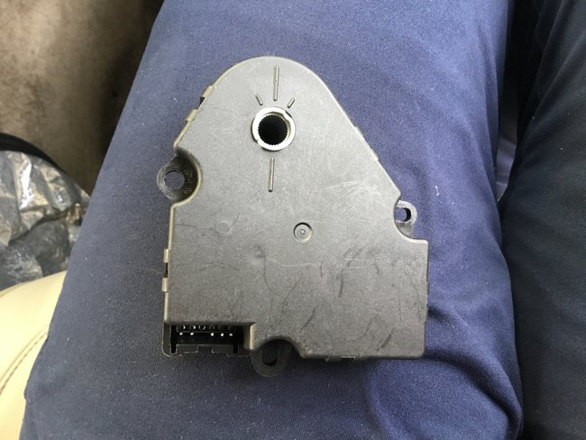

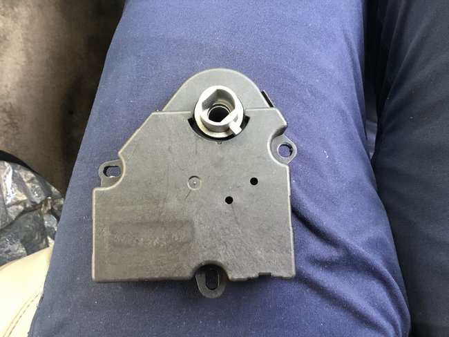

  • 21 POSTS

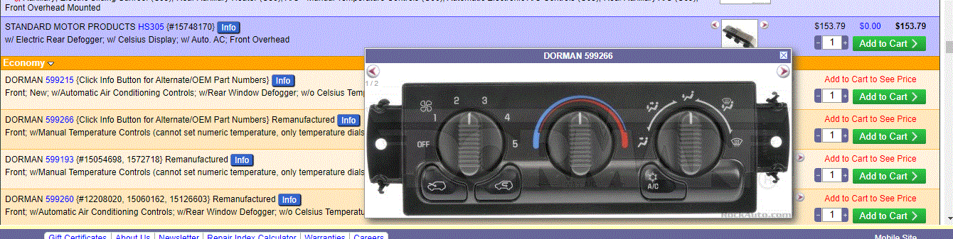

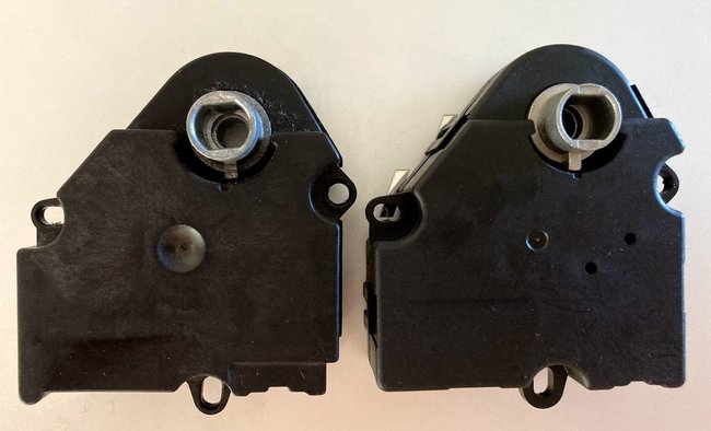

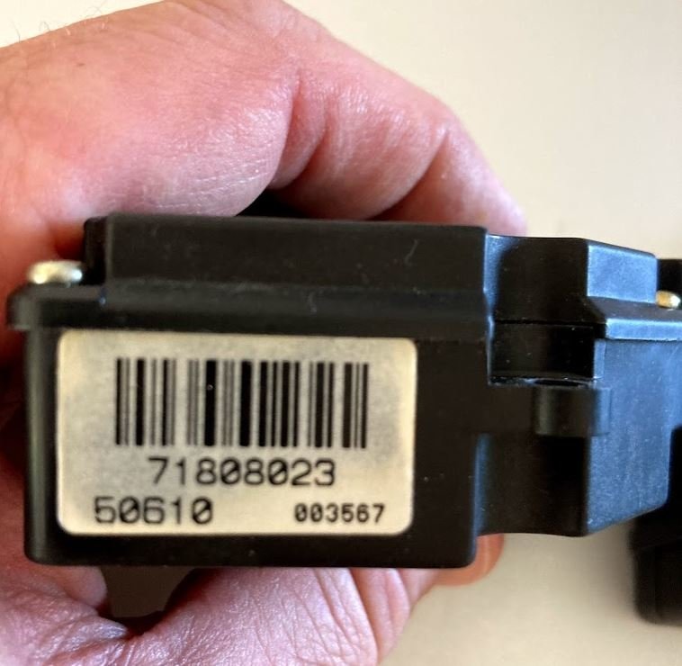

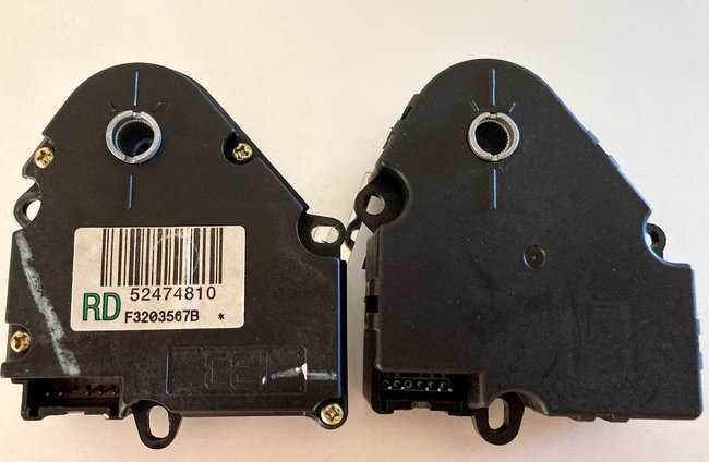

Also, could it be that I simply have the wrong replacement part? The part on the left in the pictures is the one that I pulled out. The right is the one I bought. I did buy the part off Amazon. While Amazon says it's the right part of the vehicle, perhaps it's not what is needed? The picture with the part numbers is the old part. The new part doesn't have any labels the pins appear to be the same - 5 pins with 3 next to each other, a space, and then 2 more pins.
Sep 11, 2020 at 7:09 AM
They seem to be correct.

Where did you get this control head?
Sep 11, 2020 at 9:03 AM
MCKAYABROWN
  • 21 POSTS
Local recycled part. Not new. Do these commonly fail?
Sep 11, 2020 at 9:07 AM
Okay, that explains it.
Get a new one.
I attached the part in one of my past posts from Rock Auto.
