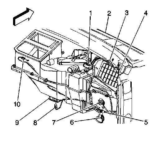

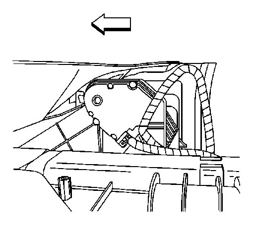

My re-circulation light comes on but it still pulls air from outside. I need to know the location of the actuator to replace.

I attached the directions for removal and replacement. The directions indicate automatic climate control. However, the recirculation actuator is the same as manual. The attached pictures correlate with the directions.
____________________________
Vehicle Heating and Air Conditioning Air Door Actuator / Motor Service and Repair Procedures HVAC System - Automatic Recirculation Actuator
RECIRCULATION ACTUATOR
RECIRCULATION ACTUATOR REPLACEMENT
REMOVAL PROCEDURE
1. Remove the air distribution duct.
pic 1
2. Disconnect the electrical connection from the recirculation actuator (1).
pic 2
3. Remove the recirculation actuator retaining screws.
4. Remove the recirculation actuator.
