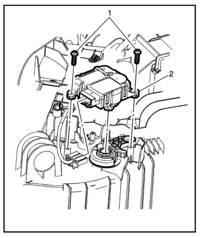

I have the dual temperature controls on the truck listed above. Turn A/C on and compressor runs but no cold air. It will change from floor to dash and all, just no cold air. If I turn temperatures up, it doesn't seem to get real warm air until about 90 degrees.

The compressor does run, doesn't cycle on and off as if it was low on charge. It has been suggested that the temperature blend door is bad, but I think this truck has four blend doors. Which one is for temperature? I'm retired living on a very fixed income and going to the dealer to scan and fix is the last course of action.

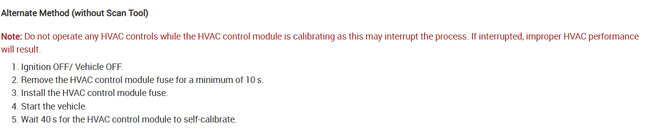

Okay, it sounds like you have a good A/C system, but the temperature blend door is not working, which is common, the blend door actuator for the temperature is on top of the HAVC plenum, here is the location and how to calibrate it after installation. Check out the images (below). Please let us know what happens.
