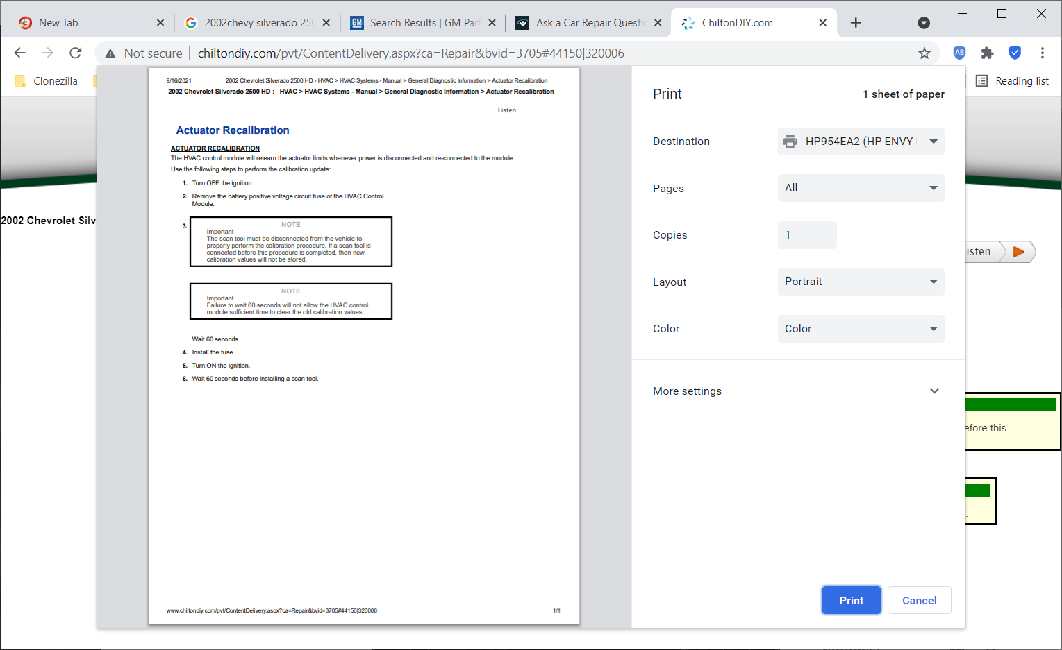

VIN# 1GCHK23112F213262 a crew cab long bed truck LS trim, and captain chairs. The HVAC modes all work correctly with one exception. The vent for the rear cabin area on the passenger side blows air all the time no matter which mode is selected I tried manually calibrating the mode door by following this procedure from the Chilton's diy manual; see attached image. I don't have a scan tool and don't know if that's required to complete the recalibration or if I have another problem. please help!

Normally, a scan tool is used to prompt the control module.. However, try this:
1. turn the key off.
2.disconnect the battery and remove the HVAC control module fuse.
3.Allow the vehicle to sit for approximately five minutes.
4. reinstall the fuse and connect the battery.
5.enter the vehicle and turn the key on. Don't try adjusting anything.
6 .at this point, the control module should automatically recalibrate the system.
7. when you hear the actuators stop, turn the key off and then back on to see if that took care of the problem.
If it doesn't, then you will need a scan tool that can communicate with the HVAC control module. If you look at the attachments below, they provide the directions.
