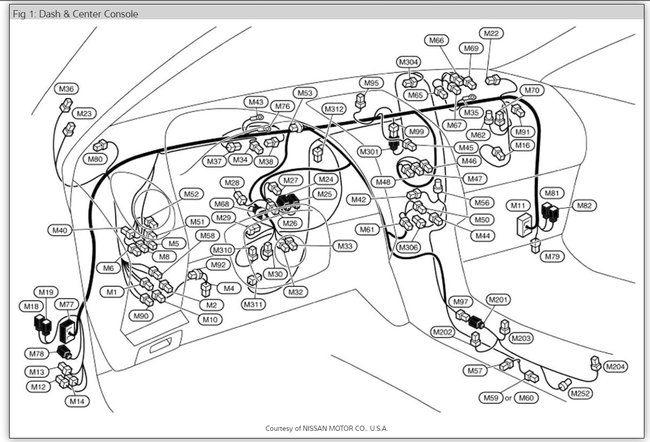

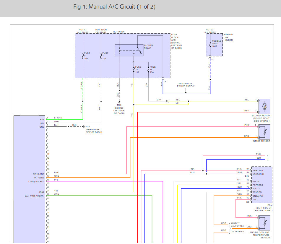

The blower motor is full blast even when the controls are off. I have changed the AC amp control as well as the blower relay. Where do I go from there?
Nov 11, 2017 at 12:00 PM
  • 55,614 POSTS

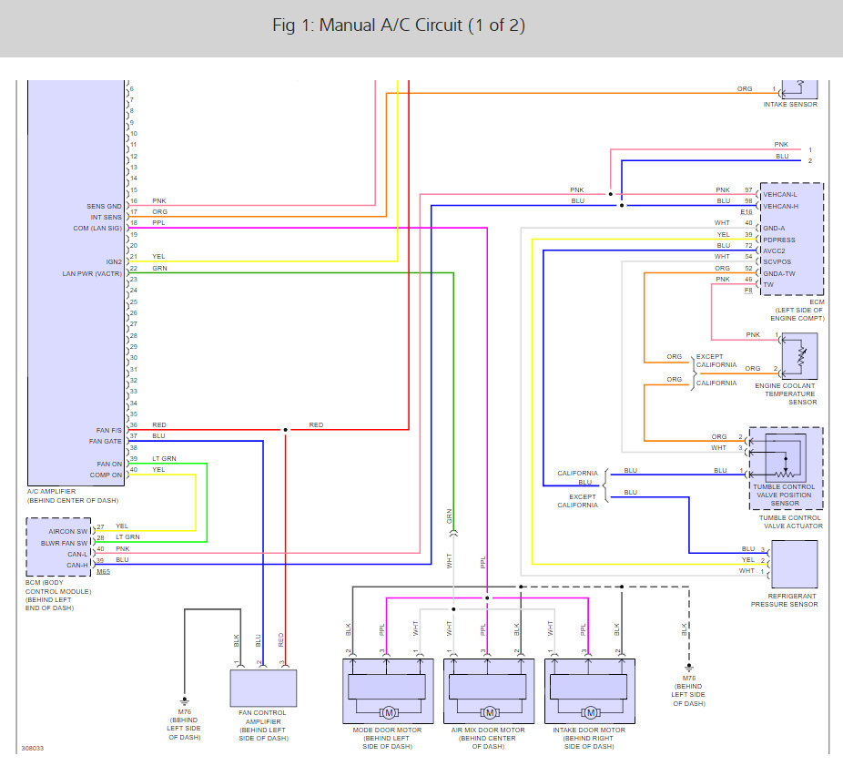

It looks like the motor is controlled by the air conditioner amplifier. You will need to run some wiring/power and ground testing before you confirm the amplifier is out.
and
M50 is the AC amplifier in the diagrams (below).
Please run some tests and get back to us.
