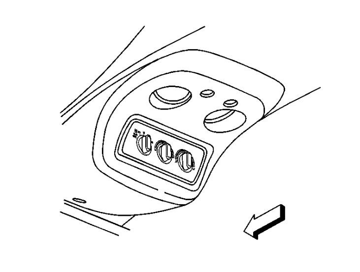

Do you mean the control head stops working?
When you have heat, is the air hot?
Have you checked the coolant level?

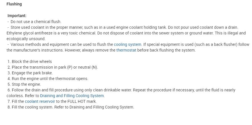

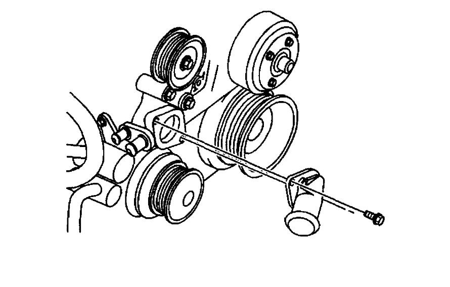

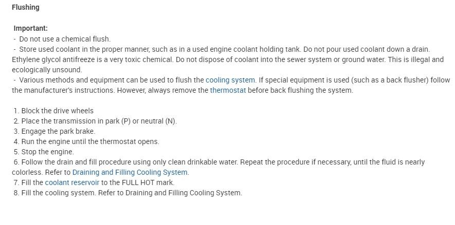

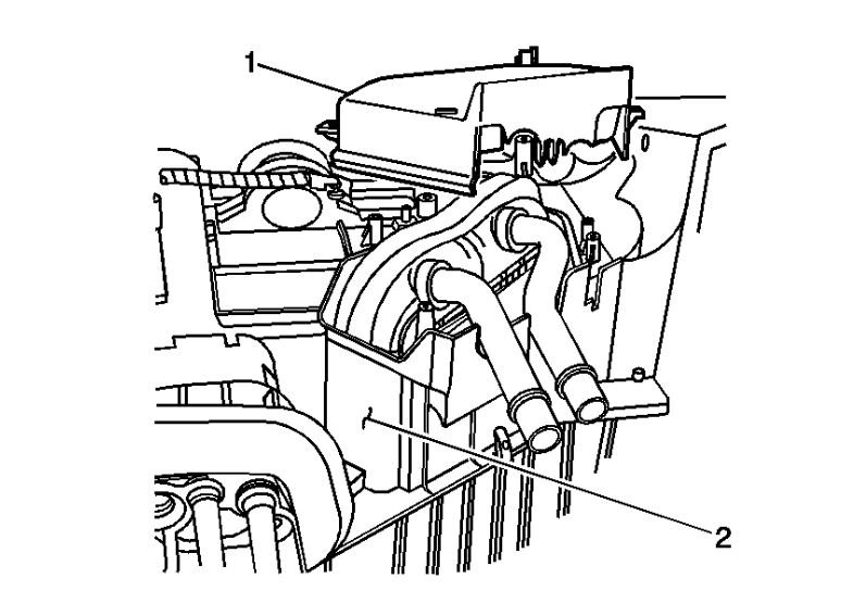

You could have a partially blocked heater core from debris in the system. Flushing the system would be a good start and replacing the thermostat.
Beyond that, if it is a control issue, the control head itself may be the issue.
