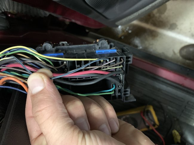

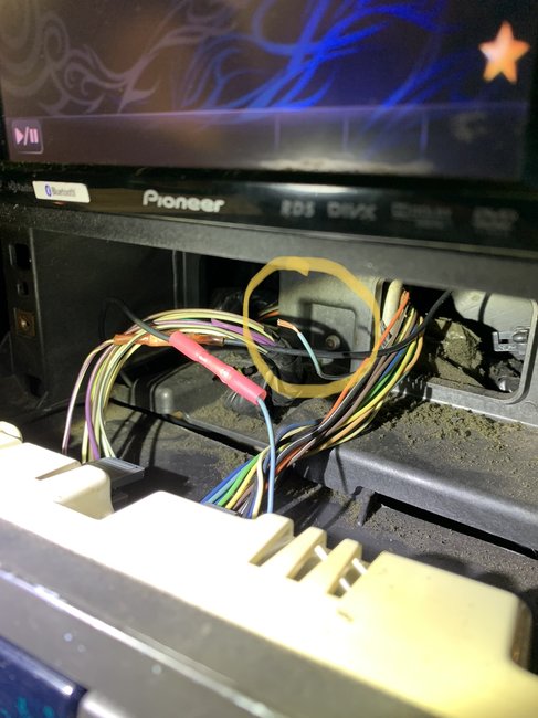

I located to junction box and found the blue/black wire that matches the one I cut and replaced behind the HVAC module. I am not getting any power from the wire at the junction box (first picture). Other wires are getting power at the junction box.
I am also assuming that the wire I cut behind the module will need to be spliced back in to provide the power? This can be seen in the second picture.

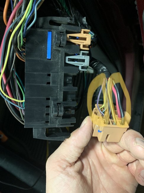

The connector block that plugs in on the other side of the target wire has power everywhere except for the three wires circled. One is purple/white, and the others are the main black and red ones.

The blue wire with the black tracer (the one you repaired) should provide a 5v reference. The idea you have no power is causing the mode door issue.
You need to go to the HVAC control module and check for a 5v reference right at the module. If there isn't one, chances are the module is bad.
I attached a pic below showing what and where to check. The idea that this wire has already been fixed indicates there could be an issue with the wire and not the module. That's why I'm recommending checking right at the module.

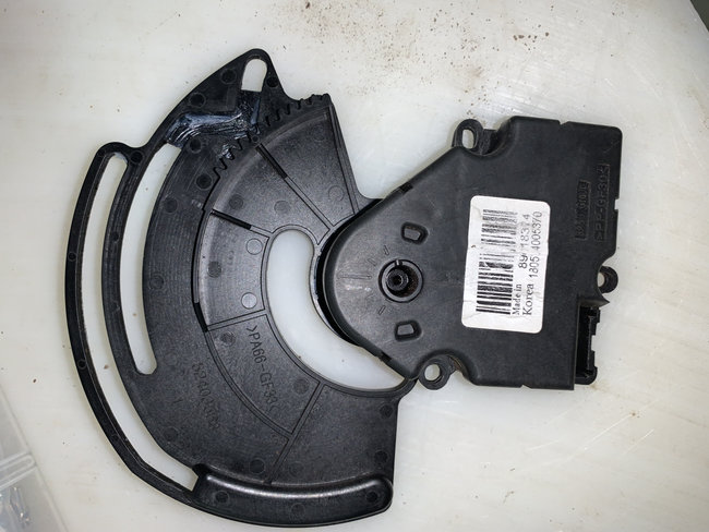

All right so I made some progress. There was 5volts at the module. I realized that I had cut the wire that ran to the junction out of the equation when I replaced the wire from the module. With the 3 loose ends spliced together I now have power to the mode actuator.
Only issue is that when I turn the key the actuator puts itself in the position shown in the image. After it moves to this position, I can’t get it to move anywhere else using the buttons on the module. I have reset it with a 9V battery but each time I plug it in it goes to this position and freezes.

Does it move when it's not attached or connected to the mode door?
Oct 6, 2021 at 12:32 PM
ZPRIME7
  • 18 POSTS
I haven’t fully installed it. I just had it sitting on the floorboard next to the gas pedal. Plugged it into the harness and tried different functions and it wouldn’t move.
