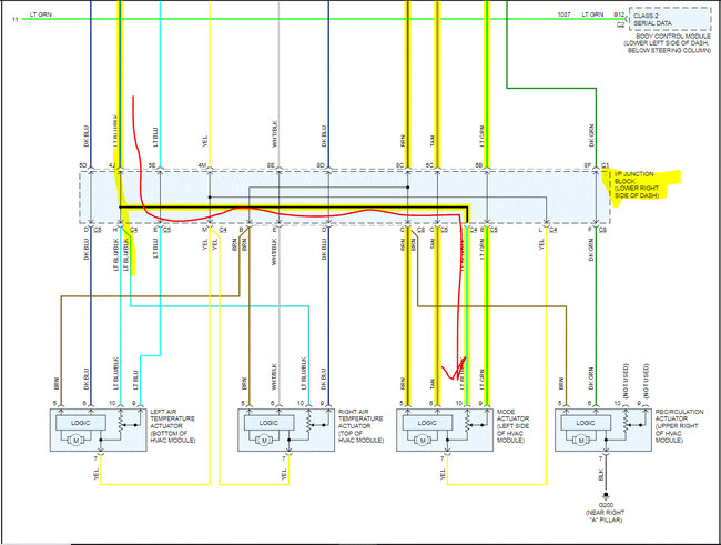

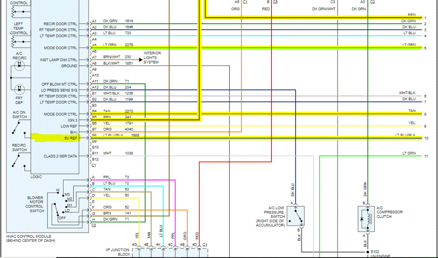

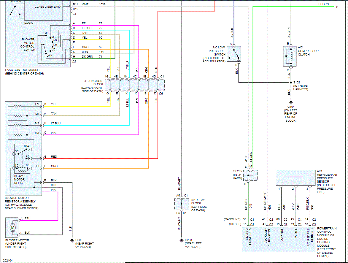

My mode actuator will not move when hooked up to wiring harness in the truck. I have removed the actuator and hooked it up to a 9 volt battery. I was able to move it in either direction.
As far as I know the actuator itself works. I can’t figure out why it won’t move when I try to control it with the HVAC head unit. All other functions work including heat/AC and fan speed.
My thought is that there may be a loose connection somewhere or the HVAC head unit is not sending correct signal to the mode actuator. What should the readings be on this harness from a multi meter? Any idea on which direction I should go from here?

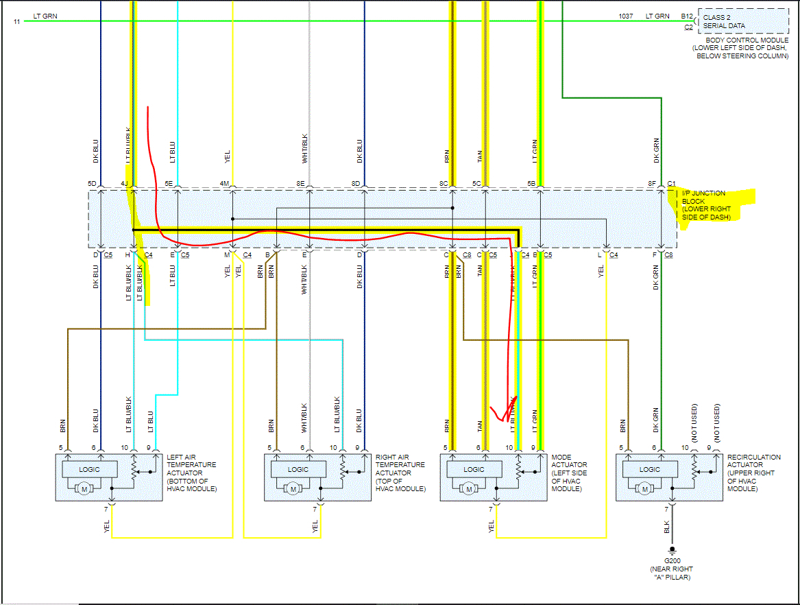

There could be an issue with the power supply, a wiring issue, or even a ground issue.
Below, I attached a pic from the wiring schematic specific to the mode door. Check the voltage signals indicated. Also, confirm there is ground as well.
Let me know what you find or if you have other questions. Also, here is a link you may find helpful:
Let me know what you find.

I checked the voltage of each pin:
5: 4.72
6: 0
7: 3.40
8: —
9: 0
10: .89
After this I checked the resistance from the pin that connects to the mode actuator to the pin the plugs into the back of the control module. Pins 6 and 9 both showed 0.4 for resistance (which is acceptable as far as I know). I’m not really sure what to make of this. I’d appreciate it if you could point me in a direction to go next.

The voltage is too low. Pin 10 should have a 5v reference. You indicated it is .89v. Trace the wire (pin 10) and inspect it for damage, corrosion, or a short to ground.

So I made some more progress but still not there…
I checked the resistance on pin 10 and it was something well over 1. I just replaced the wire and now have resistance of .04. However the voltage has not changed it is sitting at .94 volts now. I used a slightly larger gauge wire than the one that was already wired into the harness since that’s what I had at the house. Not sure where to go from here. Thank you for the help so far!

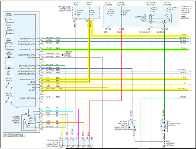

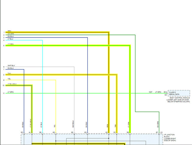

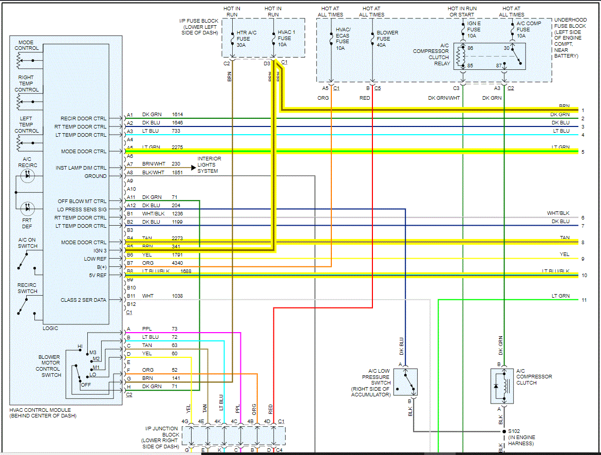

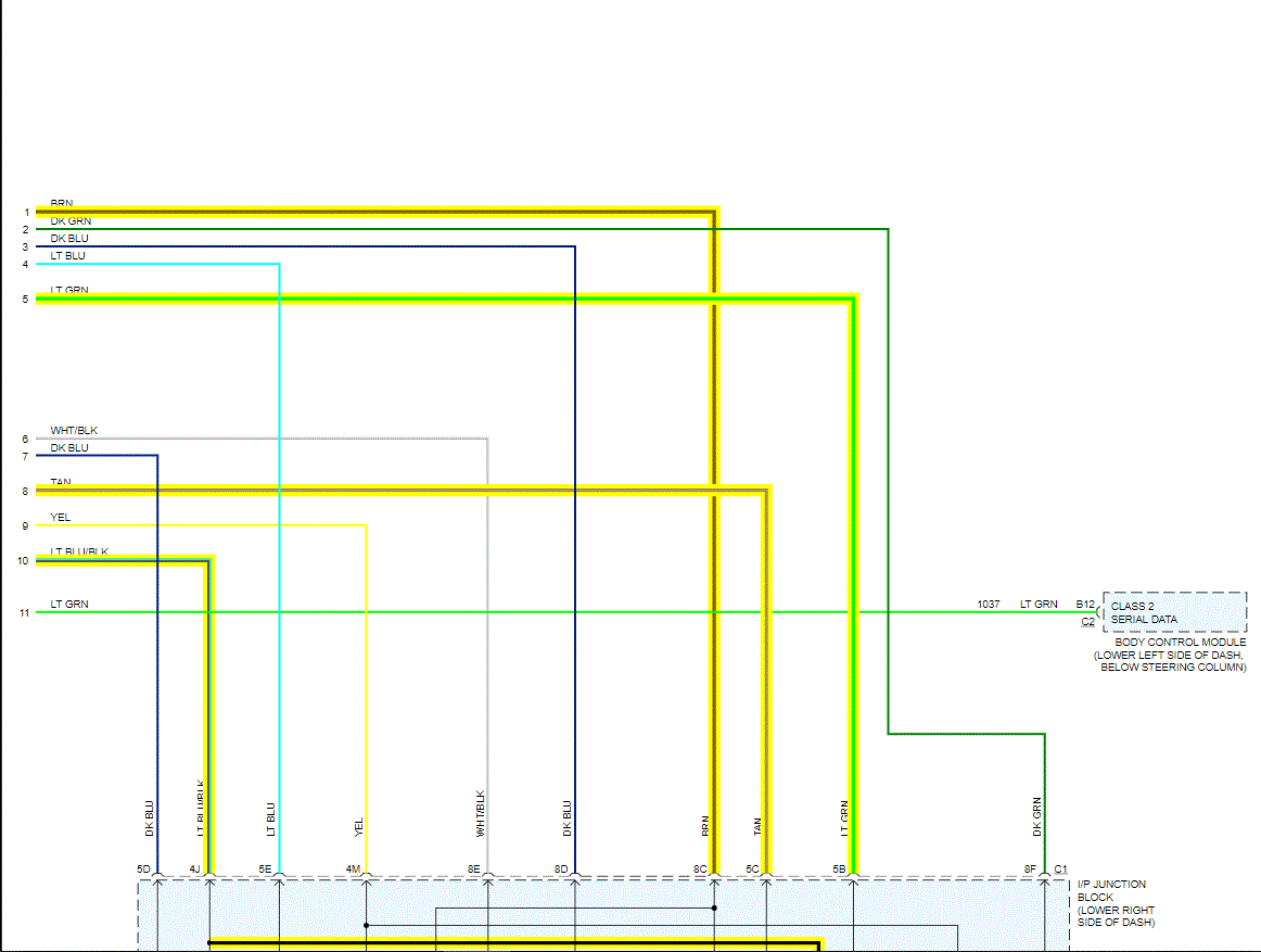

I attached the wiring schematic below for the system. I highlighted several wires that are relevant for you.
Now, since the temperature actuators are working, we are getting power to the instrument junction box. Since you are still only getting .94v at the light blue/black wire, the issue is likely at the junction.
If you look at the last pic below, I have an arrow showing how power gets to pin 10. If this is the one you replaced, go back to the junction box and see if there is power there.
The problem seems to be from pin 10 voltage.

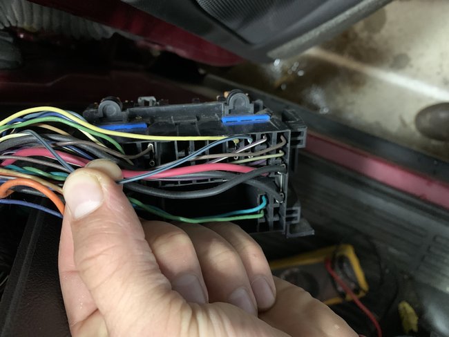

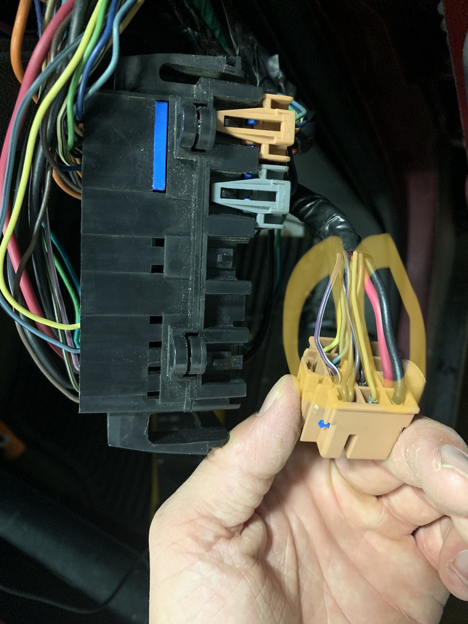

It's at the end of the dash on the right side. See pic 1 below.
Let me know if you find it.
See pic below.

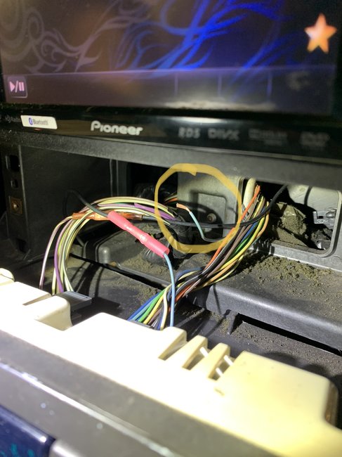

I located to junction box and found the blue/black wire that matches the one I cut and replaced behind the HVAC module. I am not getting any power from the wire at the junction box (first picture). Other wires are getting power at the junction box.
I am also assuming that the wire I cut behind the module will need to be spliced back in to provide the power? This can be seen in the second picture.

The connector block that plugs in on the other side of the target wire has power everywhere except for the three wires circled. One is purple/white, and the others are the main black and red ones.

  • 110,248 POSTS

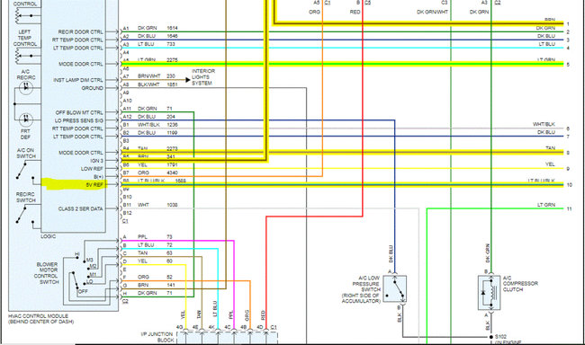

The blue wire with the black tracer (the one you repaired) should provide a 5v reference. The idea you have no power is causing the mode door issue.
You need to go to the HVAC control module and check for a 5v reference right at the module. If there isn't one, chances are the module is bad.
I attached a pic below showing what and where to check. The idea that this wire has already been fixed indicates there could be an issue with the wire and not the module. That's why I'm recommending checking right at the module.

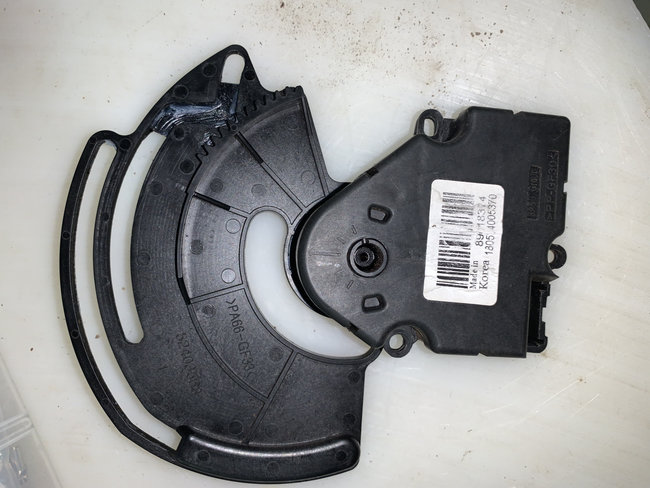

All right so I made some progress. There was 5volts at the module. I realized that I had cut the wire that ran to the junction out of the equation when I replaced the wire from the module. With the 3 loose ends spliced together I now have power to the mode actuator.
Only issue is that when I turn the key the actuator puts itself in the position shown in the image. After it moves to this position, I can’t get it to move anywhere else using the buttons on the module. I have reset it with a 9V battery but each time I plug it in it goes to this position and freezes.

I haven’t fully installed it. I just had it sitting on the floorboard next to the gas pedal. Plugged it into the harness and tried different functions and it wouldn’t move.

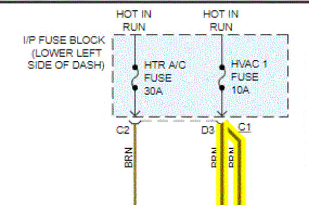

I just tested the wires right at the controller and got the same results. Also, just to confirm you are referring to the 10-amp HVAC/ECAS fuse under the hood correct?
Oct 13, 2021 at 2:02 AM
  • 110,248 POSTS
The fuse I believe you are referring to should be in the interior fuse box. It is the HVAC 1 fuse.
Take a look at the pic below. I copied that from an earlier pic I sent.
Oct 13, 2021 at 11:01 AM

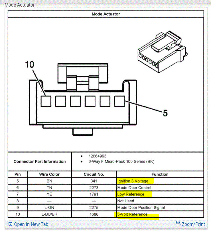

yes, it has ground and power. All of the controls work on it - I can control fan speed and whether I want heat or A/C. I plugged the mode actuator in, and it will not change position when I switch between modes on the controller. So, I'm essentially in the same situation I was in before getting the new controller.
I may just get a new mode actuator, but I don't really think that's the problem considering I can control it with a 9V battery.
Dec 9, 2021 at 9:44 AM

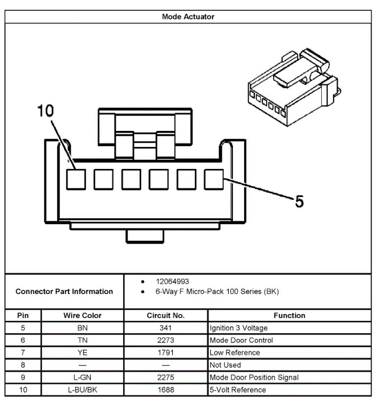

  • 110,248 POSTS
Before getting a new actuator, take a look at the pic below and check for voltages at the actuator connector. Also, check the low reference for continuity to ground.
If you have nothing there, we have an open or bad signal, which I doubt with the new controller. If you have the power indicated and ground, then it is most likely related to the actuator.

ZPRIME7
  • 18 POSTS

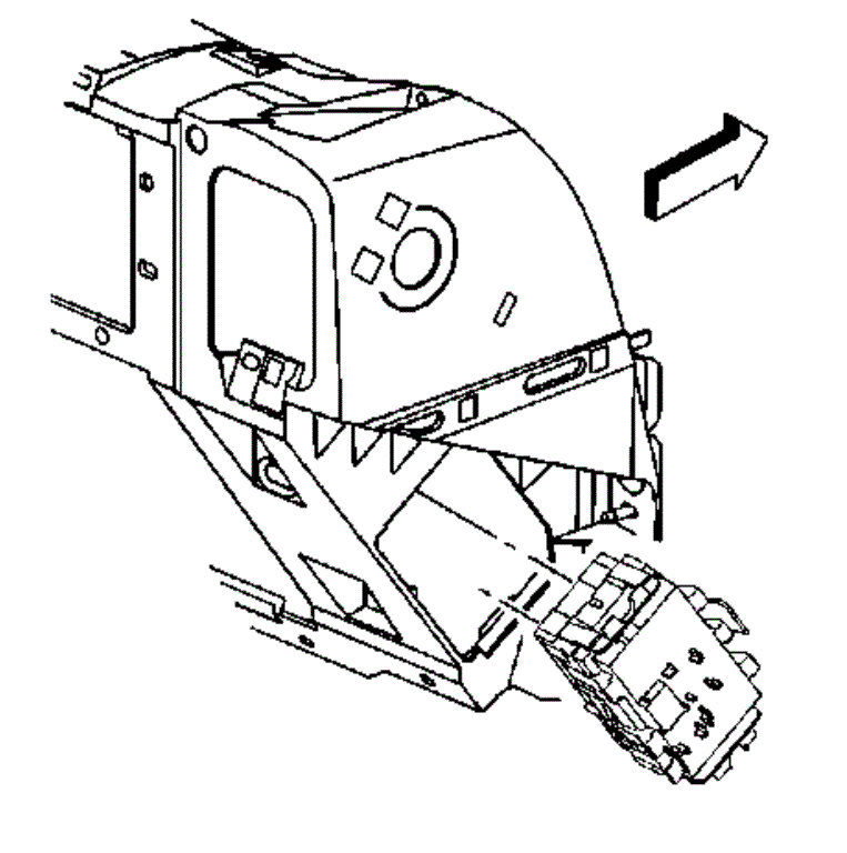

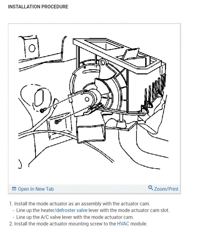

Good news we got the actuator to start responding to the controller. I’m not really sure what the problem was. I was just messing around with plugs and fuses, and it suddenly started working. Thank you for all the help!
I’m having some trouble getting it reinstalled now. I’m not sure which way the cam should be facing in order to make installation the easiest. If you have any tips, I would appreciate it. Otherwise, I’m sure I’ll be able to figure it out.
Thanks again!
Dec 10, 2021 at 5:08 AM
  • 110,248 POSTS
I'm glad to hear it's working. You must have a bad connection. Make sure the connectors are tight and undamaged. Also, make sure the fuse, where it plugs in, didn't move the connector pins.
Let me know. Also, I attached the directions from the manual below for installing the actuator.
I hope this helps. Let me know.
See pic below.
